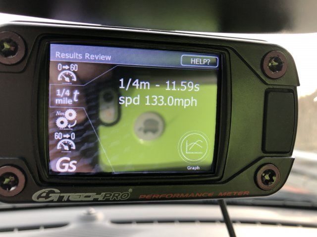

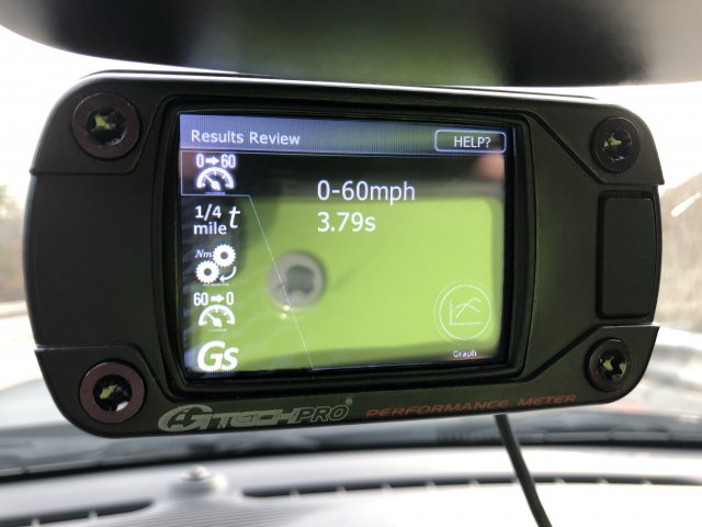

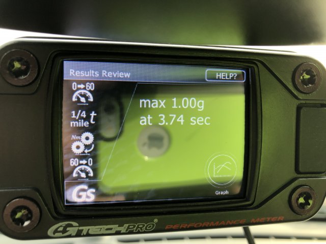

The NT05R where not far off these
Here is NT05R times on the street when they where just put on and weather and street was colder. All these runs take place on the exact same strip of pavement. My street 1/4 testing is No burnout, just launch just as if at a red light and a customer came calling next door

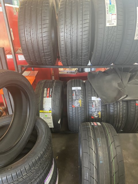

3C43DBC4-E9A0-4C06-BEC0-A54B45C3ACFA.jpeg A couple Michelin’s top left for the charger.. and there is 1 Nitto 555RII.. Massive! Haha it puts those 235s to Shame

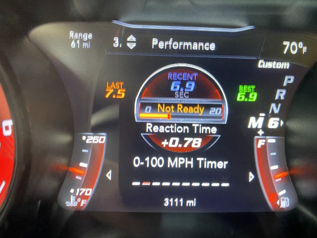

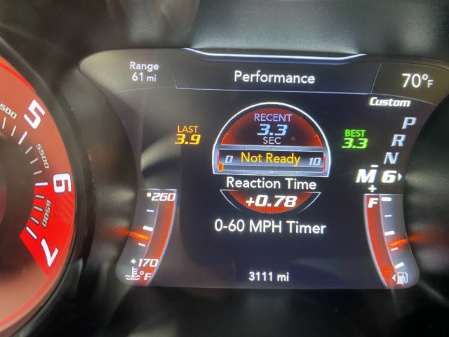

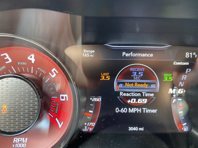

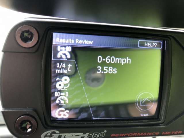

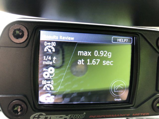

AB648CE4-A2FD-4962-8500-0711779DA025.jpeg Best so far. Was pretty hot today. Didn’t pre-burnout.. my rear tires were at 32psi hot. Was in sport trans, street suspension, traction control off & using paddle shifters. It was a bit warm so it took 7.2 seconds for it to do 100. If it was cooler I recorded the car doing 3.3 60-100 a couple weeks ago when it was 58 degrees today it was 81 then today so it took 3.7 seconds for the 60-100. I’ll report back maybe tomorrow morning to see if I can get under 7 seconds to 100 on the street with these R2s. That’s kinda my goal I set for myself. I gave it like part throttle in 1st and shifted to second in manual mode and mashed it at about 20mph the tires spun a hair and the car took off.

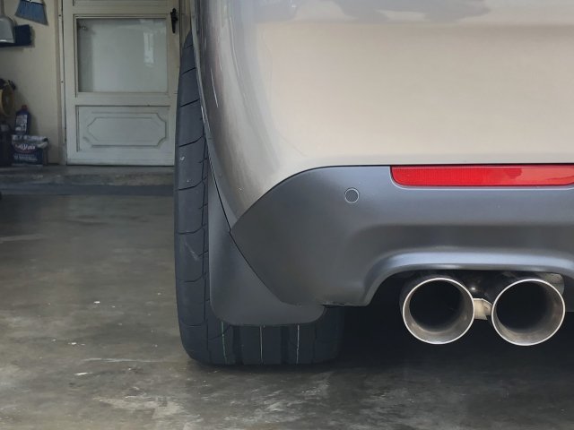

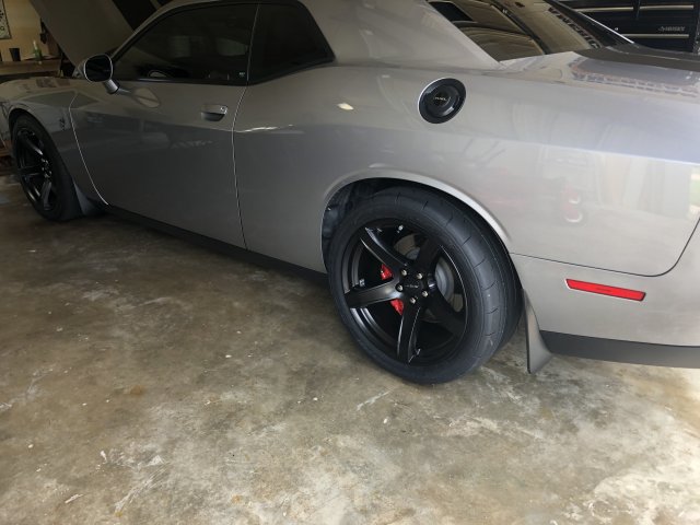

Just got mine put on yesterday , FR77 20x11 wheels & 315R2 , I like it so far , just took it out for a little & did a couple easy tip in the throttle for a couple gears & they held fine , too much traffic to try any thing real serious. Taking them to the track when I can to see what's up ?
They stick out a little but still look good.

Nice!! I like those dual tip exhausts too!!

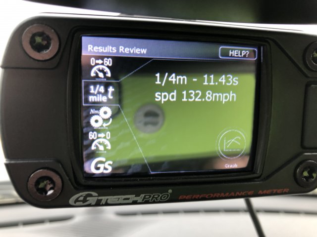

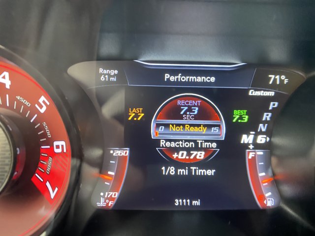

Rear tires 30psi hot. Front were 33 hot. Little less than half a tank gas. Got the 60 down 2 tenths to 3.3.. 60-100 I dropped a tenth 3.6 instead of 3.7 today. It is pretty humid 70 here today. This was my custom setting sport trans street suspension using paddle shifters and traction off of course. I think this is honesty about the best you can do on the street. I did a little pre launch twice to heat the tires from 28 psi to 30.. kinda attempting a rolling burnout but as soon as you put the car in second it just does a little jiffy spin spin getting on to full throttle then just goes. If you really did a huge burnout and were on a prepped surface I could see under 3 seconds easily.. and if it’s cooler air temp/DA in track mode settings you can expect 60-100 in the 3.3 second range. Potentially you could get in the low to mid six second range to 100 stock at the strip. So there yo go that’s the tidbit of Insider info I got for you fellas.
