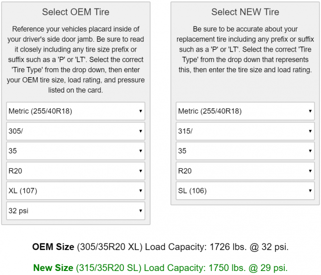

The game changer for these 555RII is that they are W speed rated, are traction rated A, and have a 106 SL load rating. This means they have excellent rain traction and at our factory rated tire pressure of 32PSI, they have similar load capacity as the factory Pirellis. Super planted in high speed corners, and a 30MPH roll has zero wheel spin or hop.
I’m praying this is all true in real life too!!

I want to know more about the compound change. Anyone have some true dirt on this that is more than the marketing fluff?
The true dirt is that the NT555RII has an SL load rating where as the NT05R has a LL load rating. This would reflect some truth in the marketing declaration of increased sidewall construction. These ratings cannot be miss stated, unless you as a manufacturer want a massive lawsuit from NHTSA if something goes wrong on the highway that can be tracked back to a tire that didn't meet specified performance ratings. Also, with a rating of 106SL for the 555RII, the maximum load per tire is actually higher than the factory Pirelli 107XL load rating if calculated at the vehicles suggested 32PSI inflation pressure. Last consideration is that the tire is rated at traction A, which is the second highest rating a tire can receive for wet traction. AA being the best, and C being the worst.
Simply put, by the numbers, these tires carry the least risk of the current common options out there to be daily driven on the street. I'm stoked this option is now available, and on my car!!
