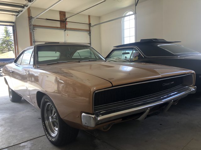

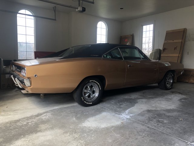

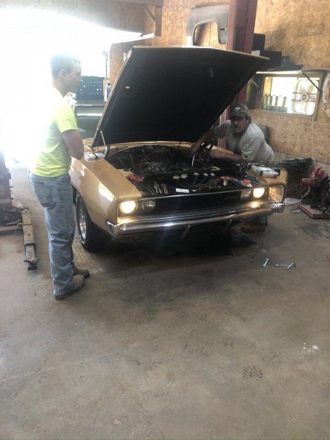

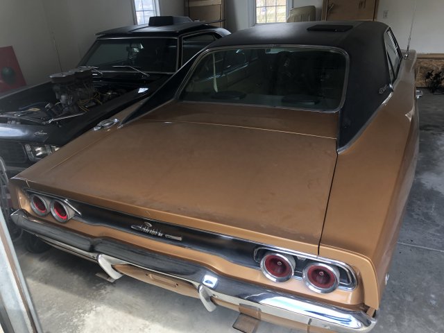

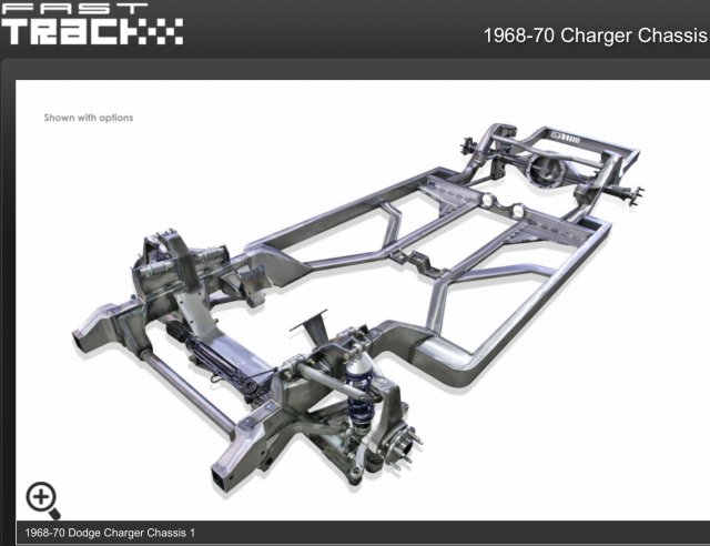

I joined this site to learn what people like and dislike about the Hellcats, in particular the motor. I have a 68 Charger that i’m prepping / researching to do a restomod on. I’m on the fence on doing a Hellcat create engine or going with built 440. I’m ordering a complete chassis for it from the Roadster Shop and need to make a decision so they can put the correct motor mounts and the correct rack. If anyone has any experiences or insite on the Hellcat swap good or bad it would be appreciated.

Is that a 69 Camaro in the last picture, sitting next to the Charger? The one with the tunnel ram intake? If so, what's going on in the headlamp area there? Kinda hard to tell from the angle of the photo...
20,159
high rise intake manifold and double pumpers.... yum
