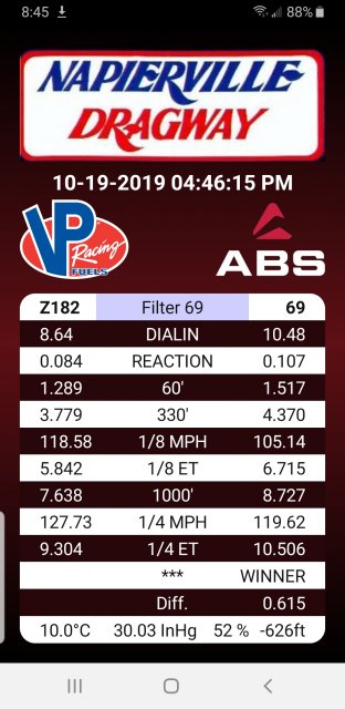

I found a video of the second round of the Vermont Cup race. Something happened with my opponent. So I let off around 1000' and coasted to a 10.50@119.
The da at the bottom has been proven to be wrong. It was closer to -400. Screenshot_20191024-084525_RacingSlips.jpg
