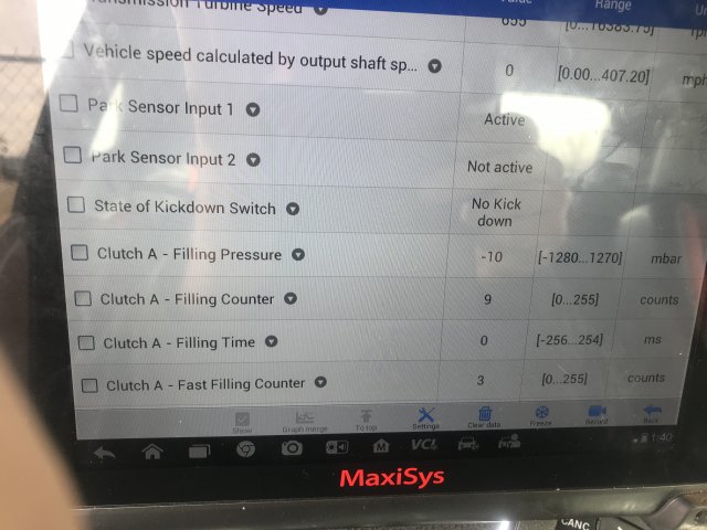

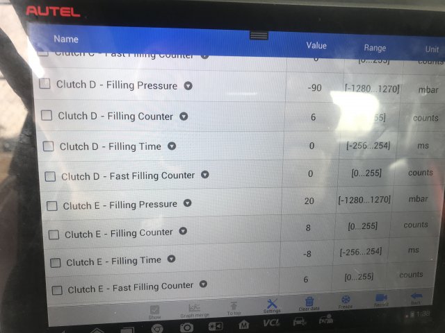

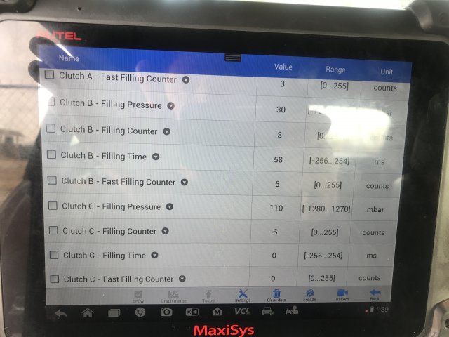

Been driving the car now since Monday and figure I’d share with you guys the clutch fill times and counters that speedy talked about 28BF6416-DE8A-44A3-A4AB-D12E7F6110D5.jpeg 730BCD33-F34C-48B5-A53E-EAA381F268D6.jpeg 46C5B741-CB69-4E0A-9012-3F3ABBE52FB2.jpeg

That's pretty awesome.
What scan tool is that?

Autel maxisys

Been driving the car now since Monday and figure I’d share with you guys the clutch fill times and counters that speedy talked about View attachment 8509 View attachment 8510 View attachment 8511
No the question is how to correlate the data into a measure of performance. No doubt that the factory has min/max thresholds for all of these values - so to turn these into meaningful values is just a matter of filtering the data and plotting it.
I was thinking about how to create an XLS book to allow enough reference data to ensure when tuning there were no conflicts when manipulating cells. And then just copypasta the figures back into the tune file.
7,308
19,155
I've done testing and chatted with folks that know more than me. I've got most of it figured out I think and my car is shifting firm and fast in sport/track. In drive it's fast but not as firm. Gonna need to dig a bit more to understand that.
The problem is there are about 100 shift scheduling tables for RPM, aggression modifiers, etc. So you have to make a ton of changes to normalize to insure everything acts the same "most" of the time. All the time probably isn't possible but you can hone in on when paddles are in use vs not to narrow it down.
burn that trans up speedy so we can turn it into the hn8hp125torqmonsta:LOL:
7,308
19,155
I'm hoping mine will last a little while. I've bumped shift pressures and it's shifting much more firm now. Maybe not needed at my power level, but better safe than sorry.
Now, someone needs to figure out when shift ID 28 and 29 are used. These are from a STOCK Redeye calibration! Found the same 6700 RPM shift points in the Demon cal as well. The conspiracy theorist in me wonders if there's some Easter egg deal like paddle down twice, paddle up twice, and hit the brake pedal for three seconds to enable these and that's how the Demon got the 9.65. In the Demon cal they're mapped to a manual paddle mode.
