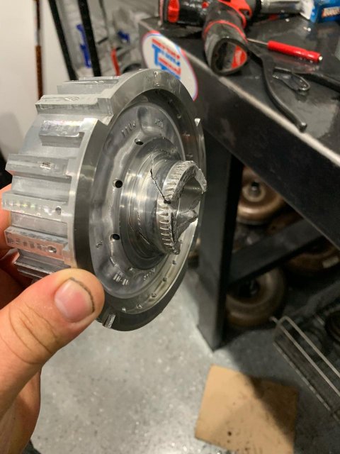

APARENTYLY THESE TRANSMISSIONS HAVE FAILED MORE OFTEN THEN WE HINK BECAUSE SINCE I STARTED ON MINE I HAVE FOUND SEVERAL WHO ARE ON 2ND OR 3RD THRANSMISSIONS IN THEIR CARS AND IT SEEMS TO BE THE HIGH HORSPOWER ONES ,ID LIKE TO KNOW IF ANYONE HERE HAS EXPERIENCE THE BREAKAGE OF THE OUTPUT SHAFT AND IF SO DID IT REAK ON THE LAUNCH OR ON THE SHIFT ?? IVE HEARD ABOUT THIS HAPPENING
My car wheelhop on launch

My car lots of runs last year 930 rwtq
Holy crap snapping the output shaft and breaking the e clutch damn
When you have wheel hop and the tires grip and let go and grip again the shock travels right up the gear train
We see that same stuff happen on tje Deisel trucks where they spin the tires and then get traction wipes out output shafts and reaks havoc throughout the entire assembly

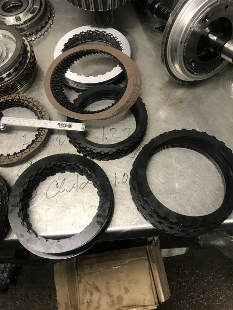

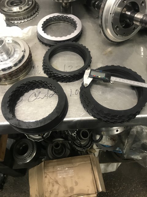

The clutches and steels came in today I’m in process of building the c d and e packs so far I’ve went from 5to 7 clutches in the D pack and 7 to 9 clutches in the C pack I’ll be working on the E clutch pack next 6030A2E3-7692-40E2-B779-82ED4C6F0CFE.jpeg 82B38EBC-0110-4EEB-990A-FF77D7B0E9DC.jpeg
1,651
14,018
Walland
21 Challenger Super Stock
The clutches and steels came in today I’m in process of building the c d and e packs so far I’ve went from 5to 7 clutches in the D pack and 7 to 9 clutches in the C pack I’ll be working on the E clutch pack next View attachment 7975 View attachment 7976
No slipping allowed!

Do you have all the clutch back together ?
When you assemble them do you install then at the min. Spec so when they seat in they are still on the tight side for less slipping?
