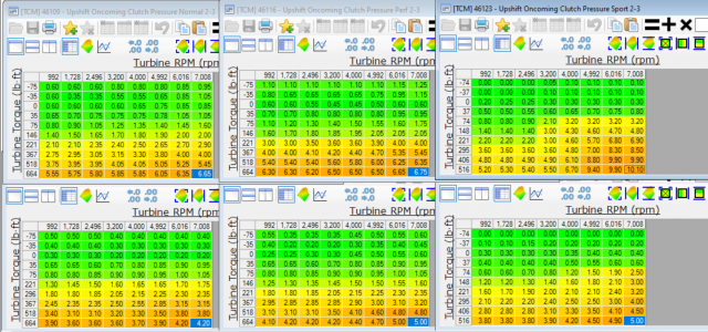

Couple misconceptions here I need to mention. Track does NOT shift harder than Sport. The opposite is true actually in most cases from what I can tell. Mike taught me that a while back as well when I used to use Track myself. It's complicated, but I found a thread discussing it on the HPTuner forum for anyone that wants to read. it has to do with driving patters, G Forces, and algorithms used to determine which table, or a blend of tables, to use for shift pressures.
https://forum.hptuners.com/showthread.php?69843-A8-hellcat-labeling
The real meat is in post #9
I've looked through all the shift pressure settings in a 2019 factory Redeye and 2016 factory Hellcat tune. There actually is no pressure setting labeled "TRACK" but there is Normal, Perf, Sport, and Max. Max from best I can tell is a base table of some kind and not actually a maximum since Perf and Sport actually have settings higher than what's in Max.
Surprisingly settings in Normal are HIGHER in the 2016 Hellcat tune than they are in the 2019 Redeye tune. Maybe due to the difference in the torque converter or maybe the extra grunt had them soften the shifts a bit?? This led me to check a 2018 Hellcat factory tune and everything matches the 2016 Hellcat tune EXCEPT Normal. The differences are all over the place so seems even the factory isn't sure what they want. Comparing the Hellcat tune to the Redeye tune Perf and Sport settings they're again kinda all over the place. The big difference is nearly all the settings for "on coming ramp" which the software defines as "oncoming clutch pressure ramp rate". The Redeye oncoming clutch pressure ramp rate settings are MUCH higher values in most cases. I'm not sure if higher = more pressure or if it's a time based value where higher = longer time?? @hellno any idea what that is doing? It's in the "Shift Pressures" "Upshift" table so I ass|u|me it's pressure.
There's not a ton of difference between Sport and Perf but in "most" areas Sport has a higher shift pressure defined. I "ass|u|me" Perf or a derivative is used in Track. Sport is obviously Sport. Here's a screen shot of a few gears showing Normal, Perf, Sport for the 2-3 (top) and 3-4 (bottom) shift so you guys can see. The pressures are different in each gear, but this is a good example. This is from a 2019 Redeye factory tune:
Note it's odd that Sport stops at 516 ft/lb turbine torque where Normal and Perf have a higher setting. Not a big deal, just weird. Sport will use the last row settings for anything over 516.
