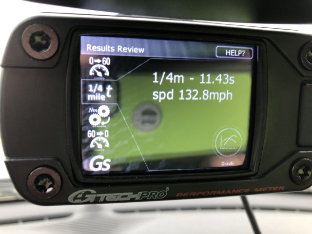

As someone looking for their first times and to start testing if the gtech is as accurate as people say it will be great for me. Ordering now.
You won't regret it.

Well, pass number 6 we did it. Full weight soft leave.
