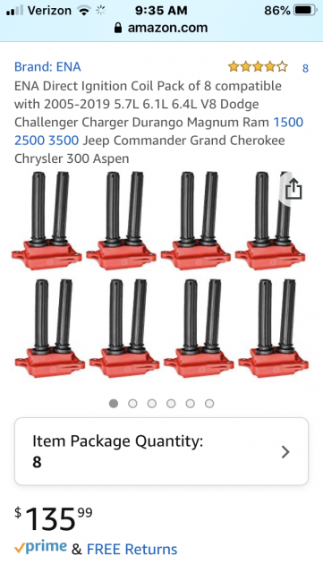

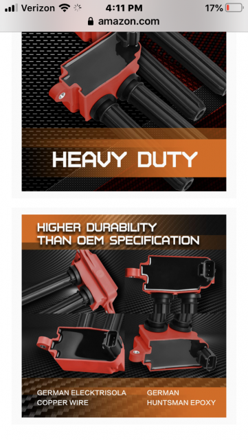

FCEE5C1D-95B1-48A0-95D9-AD417EC10A65.png 6FDF03C7-8B79-4AB0-BCAF-62E62B3ED5FC.png

Unfortunately don’t know voltage on these, their supposedly made by MSD.
Myself, I’d probably buy genuine MSD, I come from the school of hard knocks and you get what you pay for. For testing purposes or back up spares I’d use the cheap ones, for performance upgrade, longevity, and especially high boost applications I’d use genuine MSD
View attachment 24010 View attachment 24011
I agree, you get what you pay for normally, that's why, if I needed them, would buy the PD's SOS (Sultan of Spark) with the 40k volts at $379, not bad compared to the others.
I've noticed that if they don't say the voltage, it's probably not that impressive.
