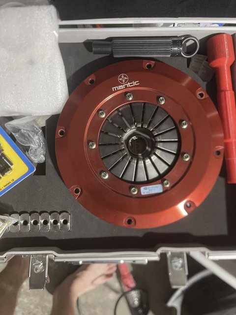

I just picked up this Mantic triple for 2200, with new TOB assy and all. Will be weighing it to compare to stock and RXT1200HD assemblies, I’ll post numbers 24945B65-B4B6-48E9-BAC3-FC27C777454A.jpeg

I just picked up this Mantic triple for 2200, with new TOB assy and all. Will be weighing it to compare to stock and RXT1200HD assemblies, I’ll post numbers View attachment 86294

I finally got this installed and a little over 200miles into the break in, so far I'm very impressed. I loved the way the stock clutch felt and have to say this one feels actually better with a slightly lighter pedal feel. Also very quiet. However, on startup there is a slight high pitch resonance when the starter hits the ring gear with lighter aluminum flywheel. The heavy stock flywheel deadens this sound. Tip that's not in the instructions is to bench bleed the slave before install. I didn't do this but could trap air in the slave that may never work its way out. Can't wait to finish the break in and will update once I start pushing it a little.

500mile break in done. Feels freakin great at high rpm... Like a hot knife though butter :cool:
I am getting just a little chatter at times. Less than I expected for a performance clutch.

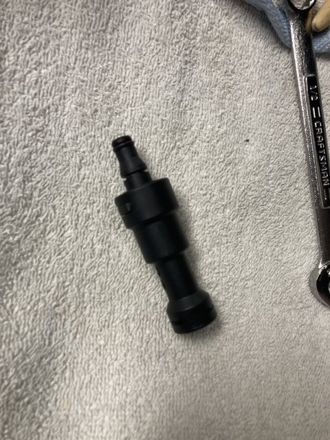

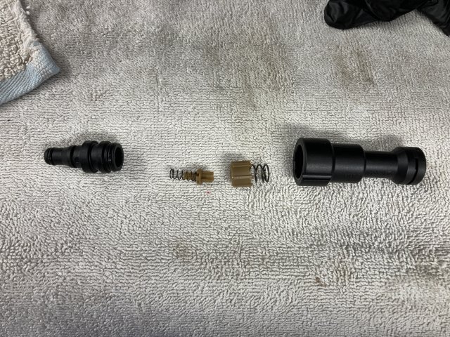

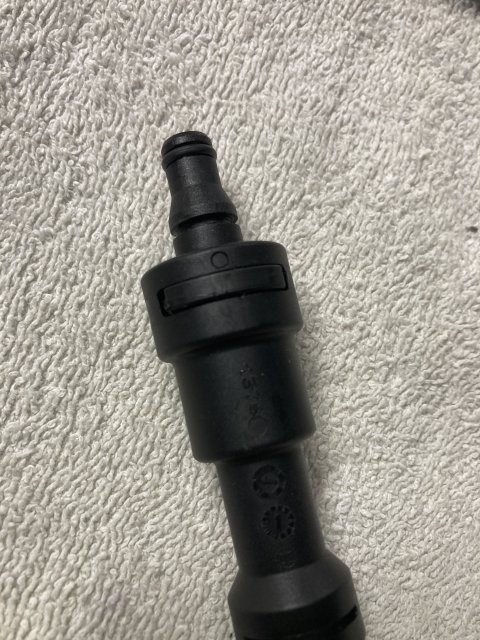

Take the REAL CDV valve out and your chatter on start off issues go away I bet. Just take it out and take the internals out of it and put it back in and see if you see a difference it only takes 1520 minutes to do. You can put the parts back in just as easy too. I just did mine and it is a whole difference starting out with the RXT1200 HD no more chatter and it’s not really picky to get it right anymore.

Yea, want to leave it there then. Lol but I tell you what a difference it makes in how the clutch feels on start off. It feels just like a stock clutch now perfectly easy and smooth. I love it now.
