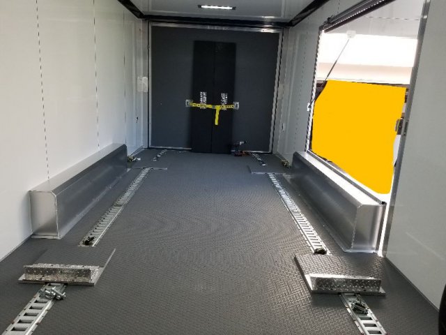

These tire stops and plates are indexed to the E trac , I can move them forward or aft to change the tongue weight, tied down with tire nets only way to go
Looks like an ATC?
