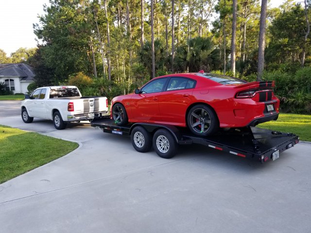

Looking to buy a trailer and need feedback.
BTW, my Ram is only rated at 8,100 because if the Power Wagon suspension (Very soft) but the same truck without the off-road springs is supposedly rated at over 10k...

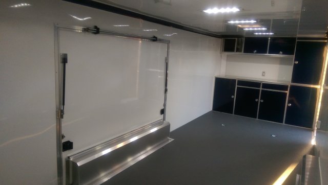

Almost none of the trailer side doors are low enough to open your car door. You will have to build up the floor to raise the car a few inches or get the aluminum trailer $$$ like Dave K has with the gull wing door and a removable fender. In any case, you need an open trailer. The 3.21 rear kills you. If you expect to tow on interstates at 70+ mph, you should still plan to get the adjustable load distribution hitch and maybe the additional anti-sway device.

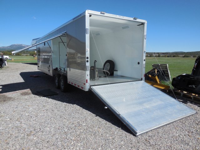

My ATC is a great trailer. Tows like a dream. I'm actually pulling it right now heading home from Bradenton. I highly recommend 1 of these trailers or an Intec.

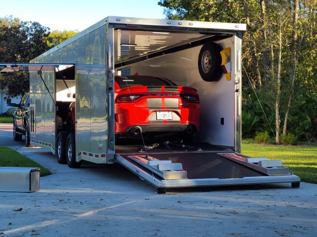

Don't forget to figure in about $5K in accessories that you're going to need for the trailer. I had to get ramps installed because the Charger is low, generator, spare tire setup, fuel can holder's, etc.

I don't like towing with a 1/2-ton at all, but if I must, this is about the upper limit. DSCN4642[1].JPG
This was a good setup with the 3.92 and the etorque. Not for the enclosed trailer.

Look at the folded up ramps on my trailer. I had to get them installed because the splitter was getting torn up going in and out.

GOOD LUCK finding an enclosed trailer in that price range ! Trailers hold their values really well. If you're looking for a quality aluminum trailer, This 2017 ATC Quest 305 trailer was $23,000. I would probably get the same price because the new 305 trailers are near $36,000 now. If you're looking for a trailer with a side door, not all the wheel wells come out the same way. On an ATC trailer the well comes out without tipping it in first. If you have to tip it in with the car in the trailer you won't be able to get it out
Yeah, yours are what got me thinking about this again. Do you know what brand they are?

I just dropped it off at storage. They're called Pit Pal or something like that. I'm going to try a search.
You want to do this right. The splitter on the Charger got ripped getting caught on the edge of the main trailer floor trim strip.

https://pitpal.com/ramps/
