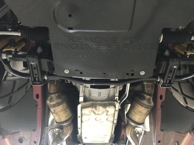

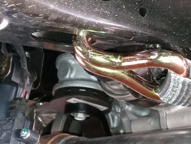

I have tried the over the tire straps using L Trac (royal pain in the ass), and just about everything else. I have settled on one setup and will never go back. It's fast , easy and secure. 4 Tie downs with a conventional plate hook on the ratchet end and a double wire hook on the working end facing up. In front I hook into the round hole in the cross member right at the back corner of the plastic pan that you remover to change the oil. The plastic barely covers a small part of the hole but the hooks go in anyways. You can cross tie or straight tie as you wish. In the back I tie into the round hole on the bottom of the LCA. You are so low that the hook will not come out when the car bounces. Cross or straight tie as you wish. Go on fast and come off fast. Get them TIGHT! Don't be shy.

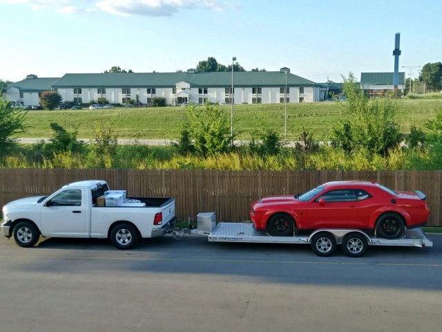

I have a 2016 Dodge Ram 5.7 BigHorn edition. Class IV receiver and this is the following tow rating:
I have a 5.7" Box and it is 4x4, 8HP70 with the 3.21 gears. I also have aftermarket airbags installed from AirLift with integrated compressor, they are very nice. I am capped at 8010 based on this chart. I've been looking for an enclosed and my racing buddy will let me keep it at his property and of course he gets to use it when I am not racing. I am looking at this a Cynergy 8.5x24 Black 10K GVW with a 6’6” Interior Height. This is from a good local reputable place that recommended the 10k and 24' based on how little room there will be once the hellcat is in there.
So a couple of questions for the members, does anyone else use an enclosed that is smaller than 24' with our hellcats, how much room do you have? Does anyone have experience with Cynergy brand? The hellcat with half a tank and me in it weighed 4505 at VMP I'm over estimating at 4600. So that leaves 3400lbs left. If the trailer weights close to 3k I might be looking at an open car hauler.
Keep the 1/2 ton. It'll be fine. I put 15,000 miles on this setup the first year I had my Demon going all over the US. Just take your time and don't drive like an ass and you will do fine.......... 0911181835_HDR.jpg

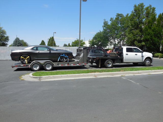

We have comparable weight cars on the trailers, but the largest difference is in the tow vehicles. Mine has a longer wheelbase than a crew cab longbed pickup, and weighs about 9,400 lbs.
Also, the inherent stability of the gooseneck trailer is in a different league than a bumper pull. Yes, it's almost overkill for trailering a little car, but I think that's much better than something that merely works. DSCN2124.JPG
While it's not a foolproof setup (especially with me driving), it's far safer should something go wrong. And there has been a few times when things didn't go wrong because of it. Such as coming into a curve way too hot.
