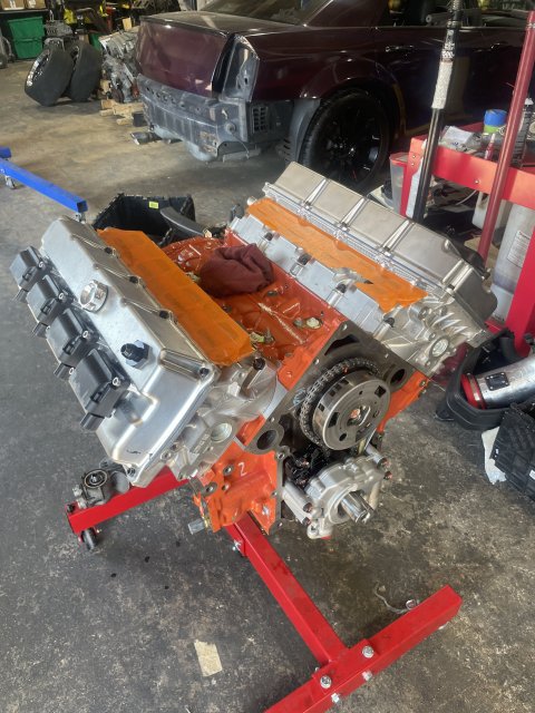

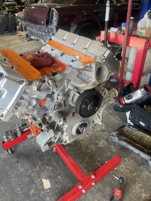

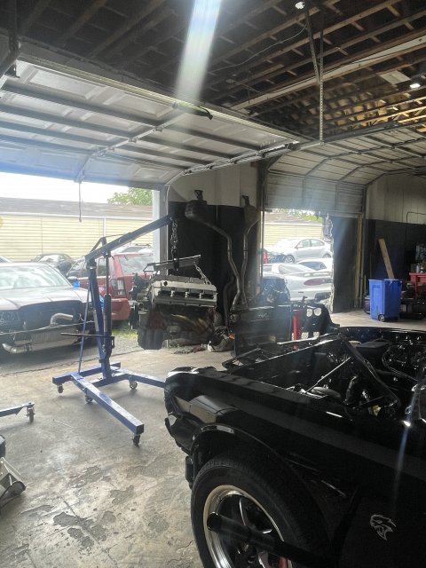

Play by play. Im doing the work. Just installed valve covers, plugs and coils. Started at 11am
4,087
10,233
Thread Starter #1,722
Timing cover and valve cover.

breaking for lunch then dropping it in

I'm out of the loop, Steve White go through the motor and fix or? What was the issue?
4,087
10,233
Thread Starter #1,727
Mmx tore engine apart, sent pistons and rings out to Mahle for inspection. Cylinders were not round. Block was torque plate honed to spec, new rods, piston, head gaskets. Cylinder heads were disassembled and tested. All within spec.

Yes actually…

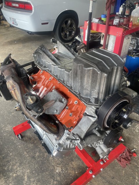

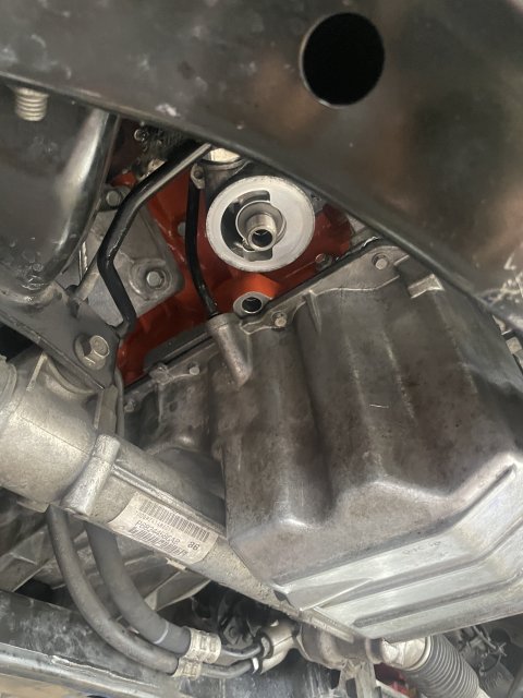

motor is in, we are buttoning up underside
4,381
10,904
Don’t forget the oil filter!
