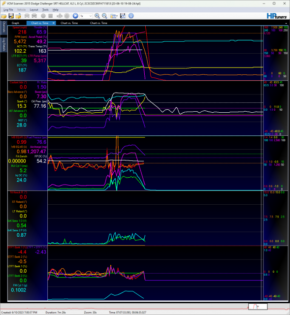

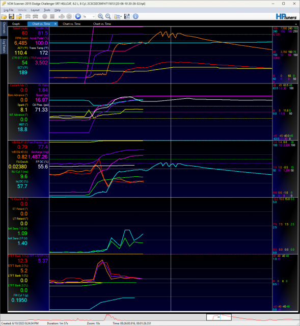

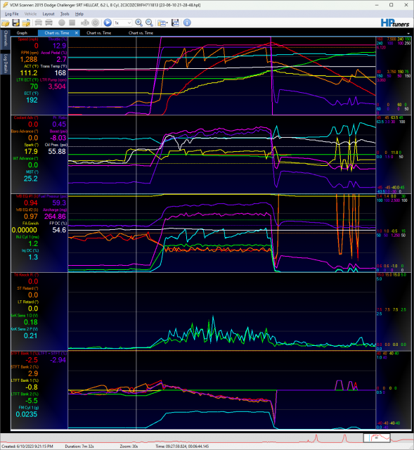

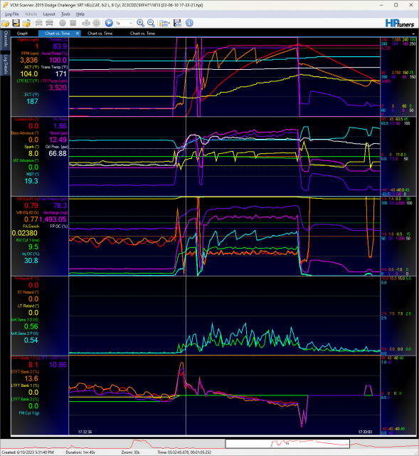

Attaching two logs just so you can see what the two step is like. One of the things that has me most excited is that the throttle is open and the cold air is coming in and the IAT's are dropping. God bless the IC Chiller. Compared to power braking the car gets hot quicker.
