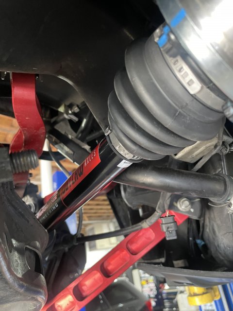

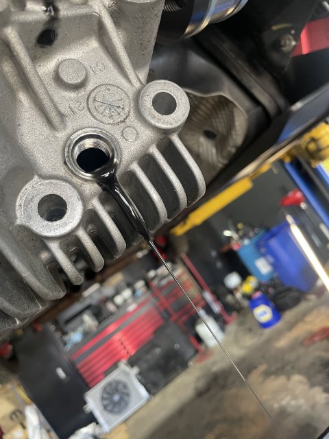

Was putting axles in, decided to service diff as well. Car feels way different in a good way. Drivers side axle was showing wear and tear.

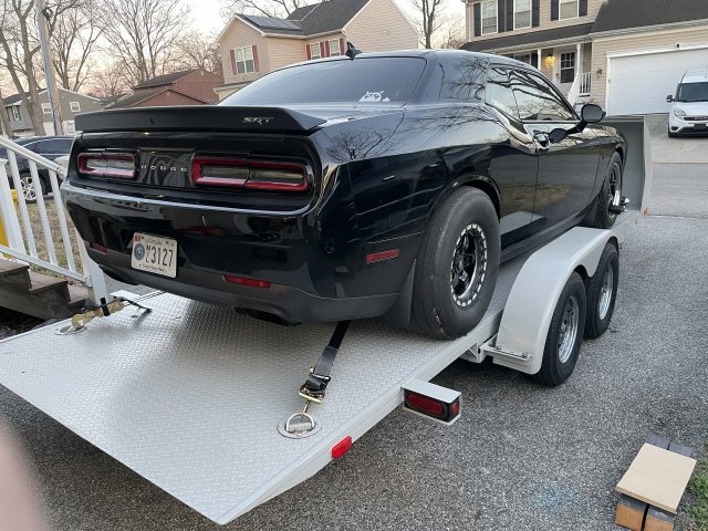

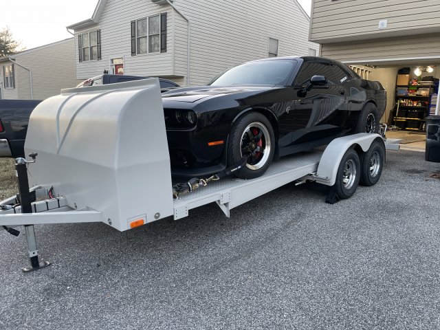

then to my delight learned the trailer would clear the driveway slope due to it being flat. I thinking I could get used to this bougie life!

Nice! Looking good on the trailer! Get used to your garage smelling like gear oil for a month lol
LOL, I learned that lesson already, I went to my friends shop and borrowed his lift.

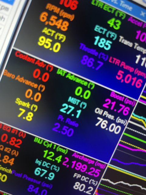

Not a problem broski. Start of pull: 62.6
End of pull: 87.8
Keep in mind air charge temps start to pull timing based on the following values in the tune:
You could move Part Throttle Ref IAT to 999 and it would never pull timing...
Didn’t you upgrade to triple pumps? Pump DC 89%, FP 79/80 psi, Or is that how it works on the control setup you’re using?
This is how it is, pump 1 is going hard but the computer don't know about 2/3
