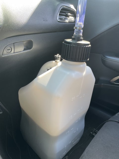

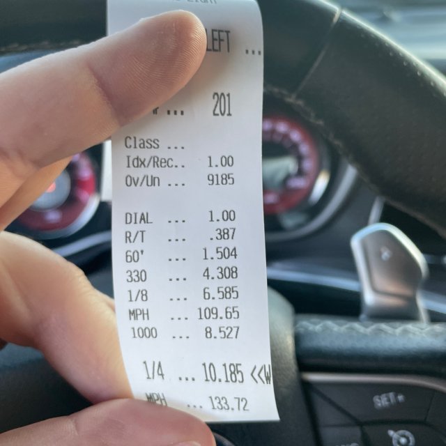

Today was the first day with the new pulley and I am working with OST Dyno on getting the tune dialed in. Mike has been 100% awesome to work with and even identified some trans troubles I may have to address soon. Currently on Rev3 of the tune and it is a baby tune. As insurance at the track I added 2 gallons of Sunoco 104 oxygenated (aka 260 gt plus). The car was a beast with what little timing was in the tune (still running 93 and I don't want to go boom.) which is around 9* maximum. Here are the times from today's run:
Right now as the car sits. I have a 10.50 index bracket car for sure. But there is plenty left in it and this is only the beginning. Unfortunately my go pro died after the first video. I have to buy a new go pro, think I cooked it in the heat last year and it never recovered lol. Also the most important part. That zero is no mistake.

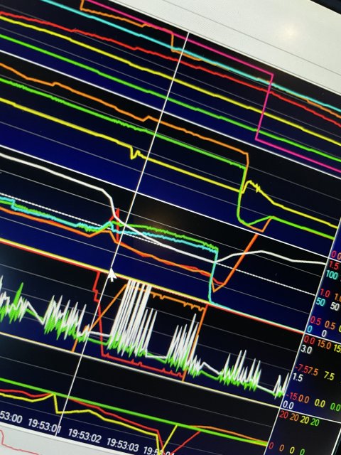

The good: set a new personal best. The bad: boost a pump is probably on its way out. The ugly: hit limp mode in fifth in the traps... Anyway still on 93 octane and locked into 10 deg of timing till I get a full race gas tune. OstDyno worked their magic with the TCM. Car was loving it.
Not too shabby eh?
white line dipping down is PSI. Went from 91 to 51... the below that all sorts of fucking knock as a result. 9B57A3FE-B454-4995-A4D0-D26284D9A4F0.jpeg
But it still hauled ass! Have a ton of good passes on video I’ll edit tomorrow. Logs are off to the tuner and I look forward to resolving those issues. Might need a better fuel setup? Might need to refresh the trans, who knows...

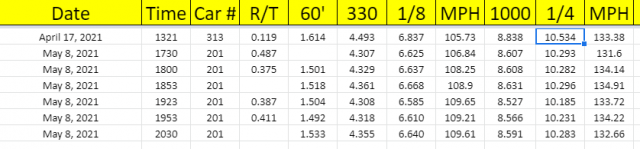

Here's all the data from the races that day. Left a day in from the 17th so people can see how much faster the car is moving. This is due to a TCM tune being tested. If anyone modifies a hellcat and doesnt get a TCM tune done they are doing themselves a disservice.
Videos coming next!

Nice testing and coming up on what my car ran on 93 with the 2.72 pulley and OST tune. Any reason no race gas being used? My strong recommendation is to put some race fuel in the tank and run your 93 tune if you're trying to see how fast the car is on the pump gas setting. It's just a good practice when beating on it.
4,129
10,396
Thread Starter #113
I ommited that I use two gallons of 104 (Sunoco 260 GT plus) with 93 as a preventative for knock. This is the strategy we agreed upon to prevent knock. Sorry for any confusion.
7,564
19,833
Good deal.
Driving around w that gas container in the car?
4,129
10,396
Thread Starter #116
Only to the track and back. Never when in and out of town. No where else to put it. Don’t trust it in the trunk (nor does it fit). 🤷🏻‍♂️

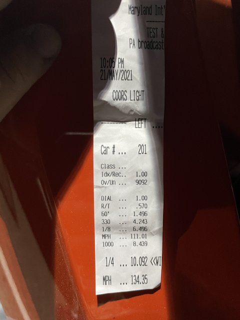

She was booking tonight. Was running N/T testing. Still on 93 with 10* of timing. Great news though, no knock at all! Time for that race gas tune... 😈
62,120
216,953
looks like the DA was pretty good around 200
4,129
10,396
Thread Starter #119
DA was good. When I ran that time, the humidity was around 58% and the grains size were 56. The cooler air and DA for sure helped. Will have a quick video up this weekend. It was a lot of Hellcat on Hellcat crime last night. 🤣
