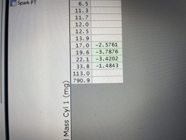

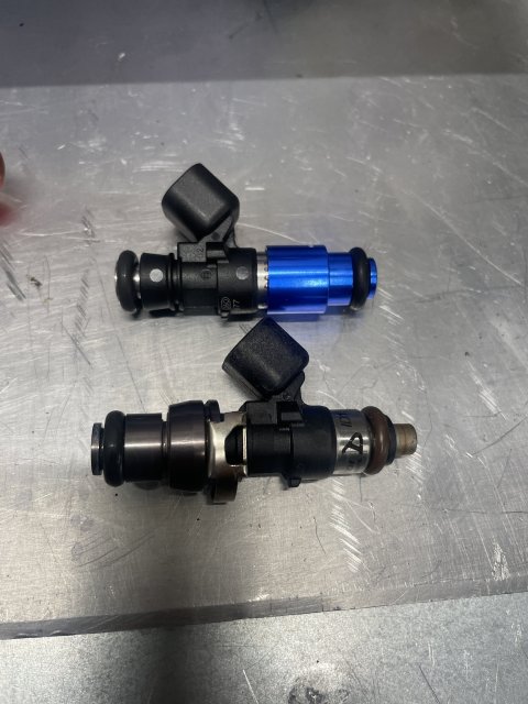

Dropped in some new injectors thanks to @Jon-MooredPerformanceLLC its interesting to see that FIC data uses the whole table where ID does not. The Inj PW vs FM data is wonky but after a couple of idle sessions and some street driving I’m sure it will be fine.
0716C42D-B22E-4A61-BA41-34E7E1B9632F.jpeg C873C901-ABD3-437D-9B72-6B4FD336CB1B.jpeg 6916EC1D-F653-40AC-BF6D-32B24C744E7C.jpeg

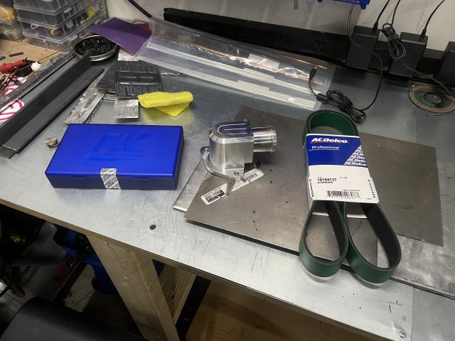

I do have to say I like the construction of the FICs more than the ID, but like the ID data better. Also got a new belt and TBA thermostat housing to put on.
Wanted to do it all today but wound up helping a friend tig weld an exhaust. Anyway if you are in the DMV and need some light welding, hit me up.

Yep I hear the injector data is way better with FIC and they idle way better. Never liked my id1300x2s
id data is way better from the factory but once dialed in at idle for sure they are way better than ID's so far, when I go WOT we will see what they bring to the table soon...

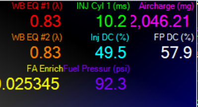

Made my first WOT pass tonight to see how far it can be pushed, saw a healthy 20psi on 2.85 and 10% lower. The other two pumps kicked on instantly so I'm not even worried about it.
She's moving some good air. Best part is, still on stock FIC data for that air. Only lean by about 2%.
Making a small adjustment to enrich the fuel trim and also, racing tomorrow in no-prep 1/8th mile. Just need test data so I figured it's a good time to test the IC chiller, the suspension, new trans.

50 percent duty cycle on the 1650s 🤣 time to push more air. Where is that smaller pulley At?
