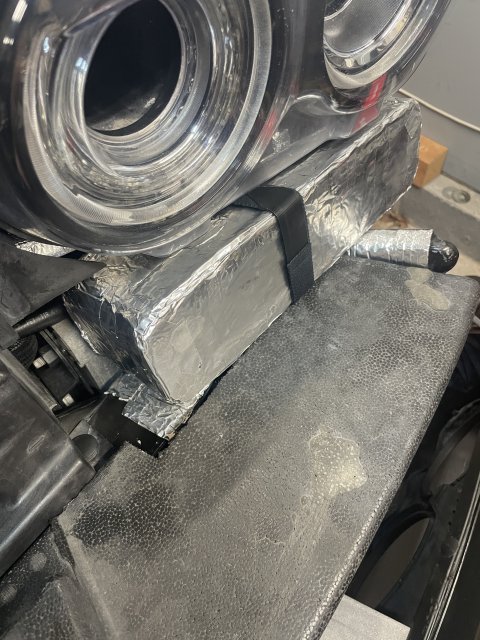

Using up that foil tape?? Fiberglass underneath??. Armaflex may work better but hard to deal with if not used to the glue. Glue is 25/50 ratings.
No fiberglas under the tape, not needed. Armaflex was used on the main cross hose from KC out to coolant tank. Used the self sealing armaflex. Everything else is wrapped in Vibrant heat shield.
Good job. You know they make the Armacell for hot and cold services now. I used some stuff in Orlando on a chiller that is good for 1,200 degrees. Even the glue was rated that high. One end was 42 the other was 1,100. Whata difference it made when we finished. Took 3 men 3 months to do this damn machine. The job looks good and the right materials. You did your home work.

Car is back on the road. For final bumper fit I had to remove the velconstrap as it interfered. You will have to trim a little styrofoam. The lip that rest on the cross member.

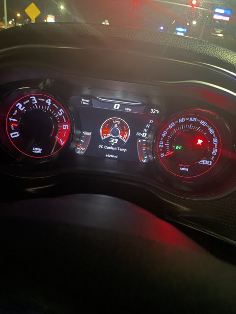

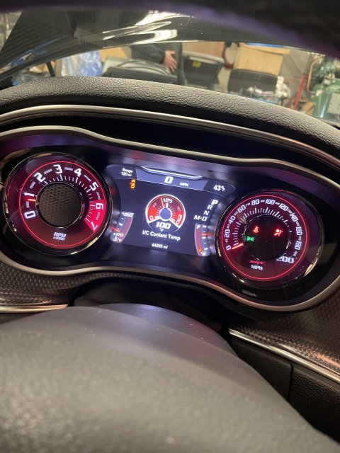

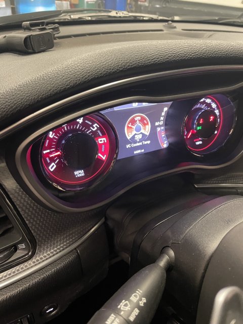

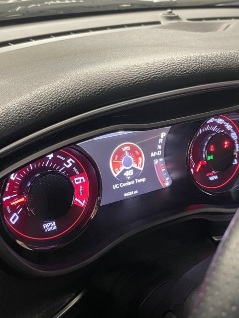

After refilling refrigerant, she was at 100 degrees, within two minutes got to 59 degrees. We had more air bubbles come out after switching the valve a few times. Drove on the way home. Super cold, as cold as the refrigerant would go. Drove home with max ac just to push it.
51C5F785-F913-4545-BE8D-4FE87103DE96.jpeg F04FC7F8-F5D1-4AAE-A1E4-086E59DB4A51.jpeg 887C6068-8905-4963-A778-526DBB3D2C82.jpeg A37E7B58-47C6-465B-BE81-C6348728C0D1.jpeg
ignore the glock (its my carry piece), we would threaten the ac machine with it periodically if it wouldnt refill it 🤣
just at idle it dropped it 40* thats impressive as hell!
That is great. Congrats. I was going to ask you the other day, if with the mods. If you thought you may need a air separators or eliminator?? Just until the bubbles go away then take em out or leave 1 in. Not very big. 3/8 brass screwed into a fitting.

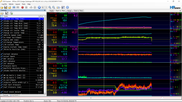

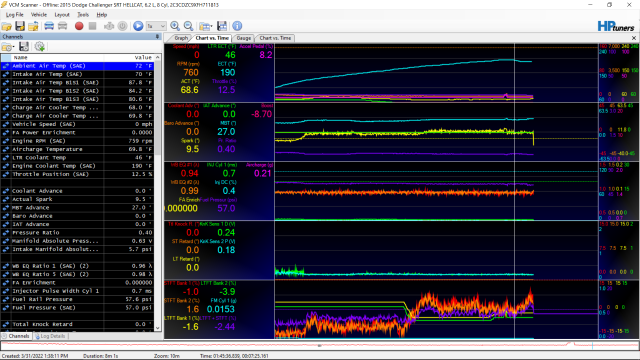

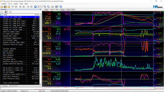

I'm still doing testing and trying to get as much data as possible. The car idled for 2:48 in this first screenshot.
Notice IAT sensors. TL;DR b1s1 is on intake, b1s2 is on snout passed throttle body, b1s3 is on the lid. All higher than ambient as the car is starting to heat up. Take note of the Charge Air Cooler sensors, those are post the bricks, one is in the front and one is in the rear of the super charger. Fast forward to idle still, car has been on for a hot minute, 7:25s in...
As the super charger has gotten hot, the air temps average out to 68.6 still, which means the KillerChiller is doing it's job as the post brick temperature is cool going into the engine. Still going to test and look forward to hitting the track tomorrow night. Also the KC frosted up on the outside, it was getting stupid cold.

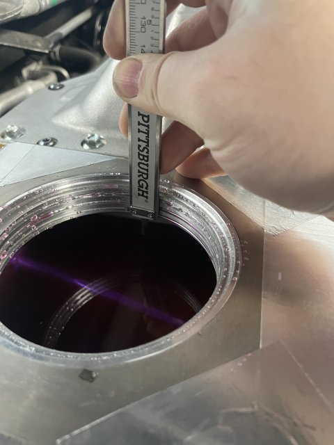

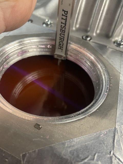

thank you for the information, strike one against me was not having enough coolant in the system.
Fixed that issue, BMR recommends 1/2 inch from lid.
second was me not bleeding from the s/c port
when i say she gurgled and air fizzed out i mean it…
