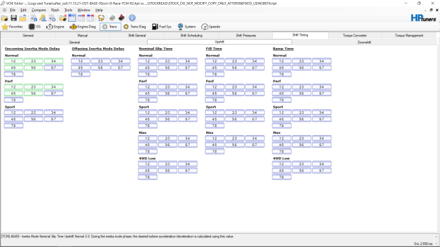

So me and Dr. Starck speculate that my diff was broken for a long time, just a roll of the dice how it welded itself back together. The axles were on their way out as well, so those two components were huge on getting me to launch better. It seems the 1.3x launches are the norm for me now. A 1.3 launch pays dividends on the back end.
On top of the mechanical side of the house I rewrote the TCM tune. After yeeting at 6850 I decided to be about it and learned how the TCM works. I started with the base HP90 tune and simply went up in RPM incrementally to get where I am at now. In addition to raising shift points I ensured that the shift pressures were set to an aggressive but yet safe level.
Didnt touch anything engine side as that was on point.

Did you mess with the Nominal Slip Times and Ramp Times at all? I just started messing with those.
I was fighting traction issues my last 2 times to the track I'm guessing my axle was also causing some of these issues and finally just broke the last outing
Doing a compare from stock the values have remained stock.
The inertia mode changes are remnants from Tuners changes.
