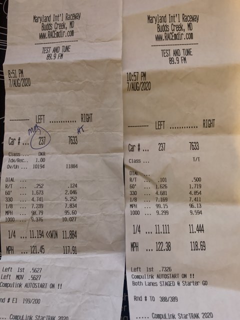

Street Fighter - Hellcat edition. The reason I added the Street Figther effects for this was the dude called me out and said I didn't have a stock Hellcat after our first run. That's okay we ran it again and I showed him the GapFather, GapSon and the GapHolyGhost. He said he'll be back from Philly with work done and that it won't matter how good I tree him. That's okay, my PCM arrives on Tuesday and I'm looking potentially talking to OST Dyno about a package. :) Enjoy!
I didn't loose sight of cutting a better tree but I'm learning that Launch Control (LC) has it's place. LC is great for bracket racing, consistent launches if you can figure out the tree (.2xx and .1xx when leaving on the third yellow, might have to leave when the second bulb goes out) but I think mastering the memphis shuffle is going to get me better trap speeds. I don't get it though cause at Cecil I was cutting .0X trees. But the best part is, more toys on the way!
5,210
9,669
Good Passes, what was your ET's & 60' ?
And your using LC ?
4,129
10,396
Thread Starter #35
The ET and 60ft line up with the data from Cecil. 11.1x is the norm for LC. 20psi rear, 85psi in fronts. I have to move my excel onto my one drive so I can edit anywhere.

Forgot to review the logs. Looks like in a few places Tq is dropping off. Correlated items are Inj duty cycle hitting close to 100%, spark dropping. Wonder what the culprit is.
