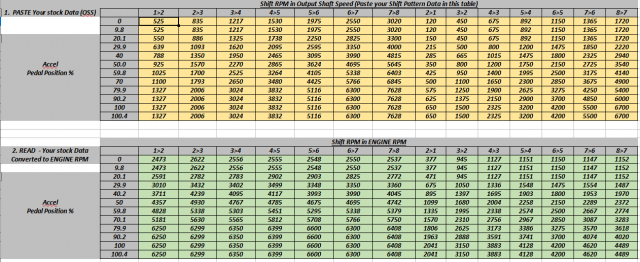

Congrats on your PB's that's awesome. At one point you were shifting too high, did you lower it & where is your shifts at now ?

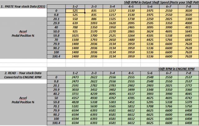

So some historical background, these were the shifts provided by a tuner that had me banging off the rev limiters hard in 1st, 2nd, etc...
These values as reported in a post that @Speedy! commented on showed that the TB was closing because I was hitting the rev limiter, hard. These are my current values:

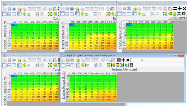

I don't have any test n' tunes coming up and I have the MHSH coming up soon. I did notice that the Tune that I flashed was sort of corrupted. It had values in them that I did not put in there. Don't know if it happened in the copy from my desktop to my car's laptop but from now on I've set the master to be the laptop and will only write tunes on that. While at the track I put the values above in the transTCM and went to get more data.
TCM RPM Limit: 7560
Max Torque Limit, Slip: 800ft-lbs
Oncomming clutch pressures:
If we are going to put this in context, please use run 6 for any exploration. That is the only run I can guarantee the values in the spreadsheet were actually in use.
Shifting at 6850 again, car was hauling ass and did 9s. I reverted to stock tune. Right now my shifts are at 5663, 5878, 6001, 6050, 6100. Conservative but I’m testing so they will go higher as I figure out what it likes.

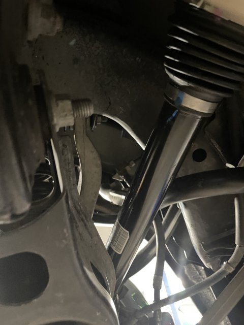

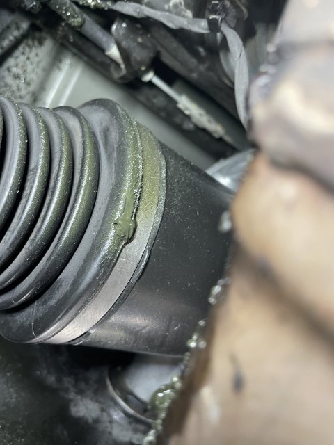

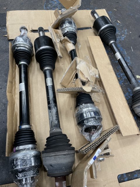

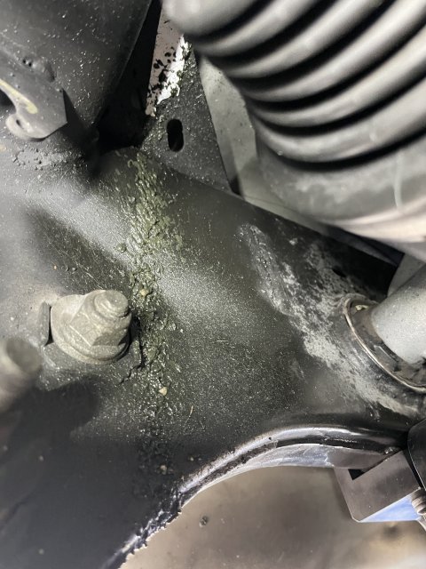

Axles finally went. Was getting major vibrations on the highway last night. During lunch got it up on the quickjacks and inspected. Good thing I have @16GoManGoHC2 redeye/demon axles. Trying to get lift time for tonight.
View attachment 57558 View attachment 57559 View attachment 57560 View attachment 57561 View attachment 57562
Ah on the axles . At least you an upgrade ready to go .
I know just trying to find lift time. Right before the mhsh, FML.

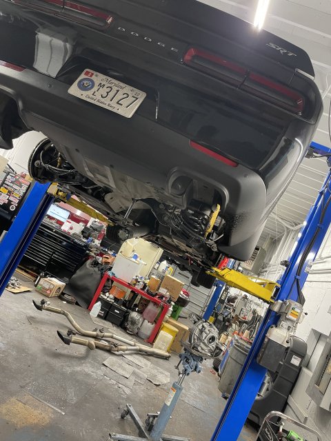

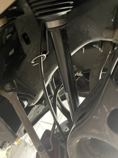

Surgery went well!
9DCE4F40-731F-4F98-9B72-39C35925E9C6.jpeg 8D552463-95FC-4B20-B55D-34DE9887E702.jpeg 3D0EDA4B-B87A-4F9C-A175-B218BDCEBBCB.jpeg 328A69FD-36AF-4C30-BC70-251E86362122.jpeg 9CDAF4EE-D259-4F12-8A5B-9AAC0220CBC3.jpeg
also got the first ride in a newly refreshed scatpack that’ll blow the doors off almost every car on this forum. His low boost setting is 25psi… 🥲 hes about to make a lot of hemis cry this weekend at the mhsh @ cecil
