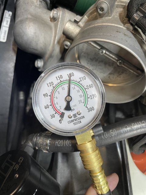

I'm done till the chiller comes in, in the meantime I'm going to do a compresson test and make sure the engine is still healthy.
A compression test is better then no test but your best bet is a leak down test as it will reveal even small cylinder sealing issues. A stock Hellcat engine will have very low leak down, like 1/2 to 1% even cold at 100 psi test pressure. With your IAT’s getting as high as they do your pistons are getting pretty hot which leads to allot of ring expansion, these engines are built with pretty small top ring gap which doesn’t allow much room for overheating before they butt. A Leak down test is the gold standard in cylinder sealing testing. A compression test won’t pick up 2-3% difference in leak down. A leak down test is something good to do even to an engine not giving any issues as knowing leak down figures for your engine and keeping track of them let’s you see a problem before it gets too out of hand causing even more costly repair when it finds you not you find it first. Excess blow by the rings gets them even hotter quicker which leads to ring butting even quicker. I think Speedy will even agree with me here, he knows where I’m coming from what ring butting can lead too.

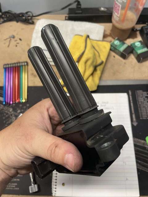

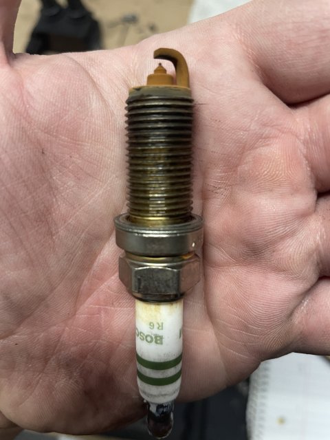

Kinda pissed, found previous owner ran boostane. Im in here and making it right. Gapping to 0.028 and she might be happier.
197B43B9-AA35-42C6-B0A8-A731BBB336C5.jpeg 1063942C-A55C-41EC-8C73-DE697BD26920.jpeg D84E8124-0C82-4094-B3D0-B324DADB3AD3.jpeg D6DF9BE0-8635-445C-8E32-B769610938DF.jpeg 1F7D06AA-1724-4AB9-842A-764201A46447.jpeg 33CD4B01-EB28-4D03-928B-217BBDB9CC9F.jpeg
I have only ever run 93 and 104 in the car. Cylinder 1 done. Seven more to go. 💪

Strangest anual probe I have seen cents I left Costa Rica in the 70s. her name was Ann U Ail. What a gap. Kinda dirty.
