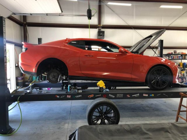

Anything with the wheels, brakes, suspension, subframes are all terrible with a 4 post lift. There is a reason 2 post lifts are in every shop.
Not quite true, very easy to get all the corners up in the air. Have 2 scissor jacks that will lift anything that I can get on it. That and a 4 post is significantly more stable.

I‘ve worked on post lifts for 20 years as career, a drive on 4 post is fine for a hobby. They are terrible for being efficient making repairs.
Agree to disagree. When I was in the industry, I rarely used a 2 post and is why I have a 4 post in my shop.
I think they each have their advantages and disadvantages, and it comes down to personal preference. If I were getting a lift for my house, I would get a 4 post since it has the added benefit of being able to use it for storage easily. Just drive on and off....done.
