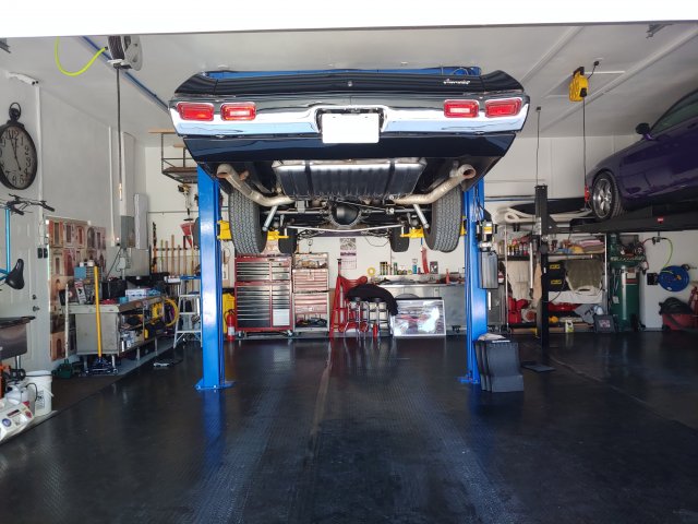

As you can see my four post has the Biscayne on it so a lot more work to make use of it.

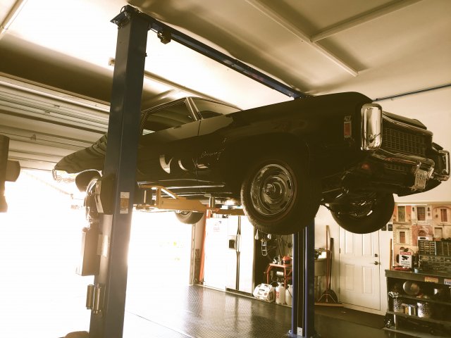

Having owned both style of lifts(two post,Four post) they both teeter a little most of the four posts are made to move so not bolted to the floor. I have had two two post lifts and I just cut a two foot by 8 foot section of my garage out and poured 6 inch thick slab there for the lift. The second one was a new garage so the whole floor was 6 inches thick. I used to live in Arizona and the house next door had a four post outside on his driveway.Only worked on cars at night out there. Way to hot

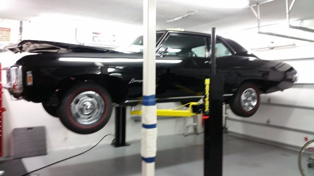

Another option is the MakJak very nice lift for a low celling garage and if you have a stable 4 inch slab it works great. I had one
