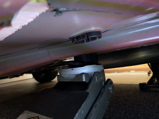

So now that I have a Challenger Scat Pack, M6, I am wanting to remove the CDV (pairing that up with a Barton), as well as make sure I have all the right equipment for performing oil changes and what not. My jack isn't really low profile enough, but I have been able to make it work with a pinch weld adapter by grinding down the fingers that stick up on the round saddle (it almost cleared prior to grinding, now I nearly ground off the fingers but hey it works! Cheaper than a new jack LOL).
Anyway, I came across this Gem:
And there was a second video similar to this one I found. I would need a different jack to reach that, or even the rearward cross member, which I think might be stronger? Anyway...I am reluctant to lift the car one side at a time (though I don't need to buy anything to do that), it doesn't feel very safe to me. I am wondering if anyone uses that cross member to jack the whole front end up evenly from the center like this video is showing? I have done this on all my other cars over the years so I don't see why you couldn't do that?
Anyone out there doing that? Any issues? I think a regular low profile jack would reach the front cross member, and a long reach low profile would reach the rear cross member no problem.
Here's the ones I use. Challenger on fits, well, the Challengers. The U View attachment 9439 View attachment 9440 niversal one is narrower and fits narrower front lift point on Charger.
The Race Ramps will allow you to do the CDV delete; don’t need to raise the car to do the Barton install.
I bought a set of replacement rear lift pads and installed them in front, further in than the rear, and a bit frontward of the pinchweld. Makes swapping front wheels at the track easy and quick.

There is a company that makes the lift pucks for the front. Many have installed them. Most cars have threaded holes for the bolts.
