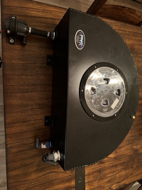

Yes. Too big to even be a option with the side mount PNR. This is what I’m using now. A custom 10 gallon tank. View attachment 112072
When you’re car was more stock and you had the half moon one lol.. when you deleted the factory pump, did you have the Davies 150 pushing All the fluid, or a reprogrammed EMP pump/cwa400?

IMG_0905.jpeg Welp, no going back now. If anyone has any suggestions or advice on routing/t’ing the coolant lines I’d really appreciate it

. First…. That was over 5 years ago. Lol. I can hardly remember what I was doing that long ago. I changed to the side mount when I put the DragPak rear in it and used the well in the trunk for the fuel cell. The Davies Craig pump is all I ever used. Removing the factory pump was part of the install from the beginning. Don’t need it.
