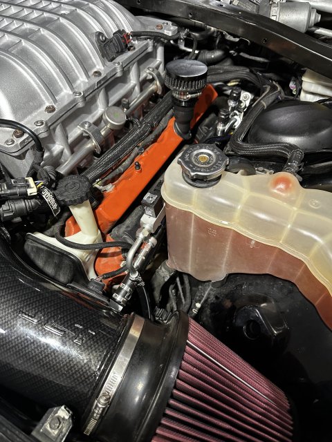

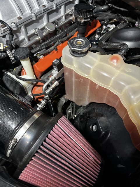

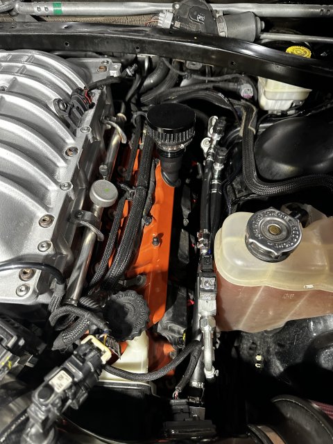

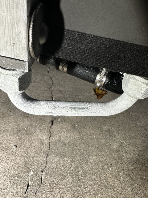

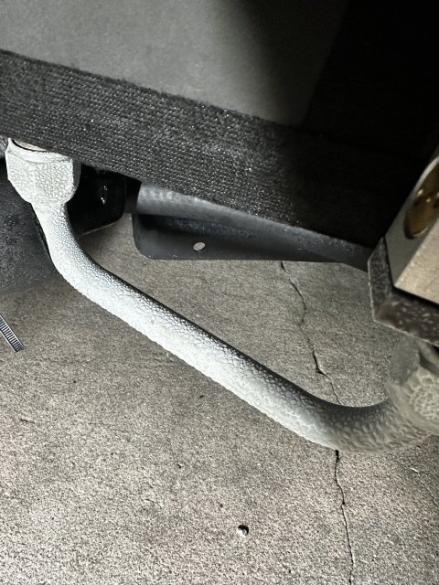

Just redid lines to have more room for plug changes and it look cleaner. Will get some thin vibrant heat wrap. Does anyone know the part number for that stuff?

I see you chose to make sure that low side suction line & T block were placed differently based on my experience. Lol.
Mine is about 1-2" further toward the firewall from the looks of it and the metal portion with the female screw on fitting is positioned such that the rubber hose made significant contact with the head/valve cover mating surface which is what caused it to loosen up.
Good work man!

Yes, I had to swing
Good work man!
Thanks! yep, I had to unscrew the very tight fitting to the compressor, swing it in, mount, indexed with marker, took it off compressor, and then tightened it with AN wrench and adjustable wrench holding fitting. I redid them last night, the lines have play in them but very minimal. I tightened everything really well, we shall see

@fubar569 if you mount the hose as it comes (screw on fitting already really tight to cnc compressor fitting), it mounts like this, which is no bueno. So I took it off, cracked it loose, fit back on, hand tighten, index with marker (I swung it in closer to block/compressor) took off and tightened

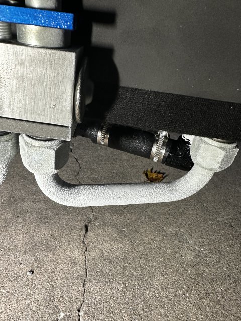

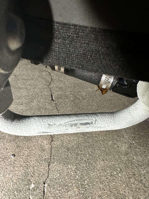

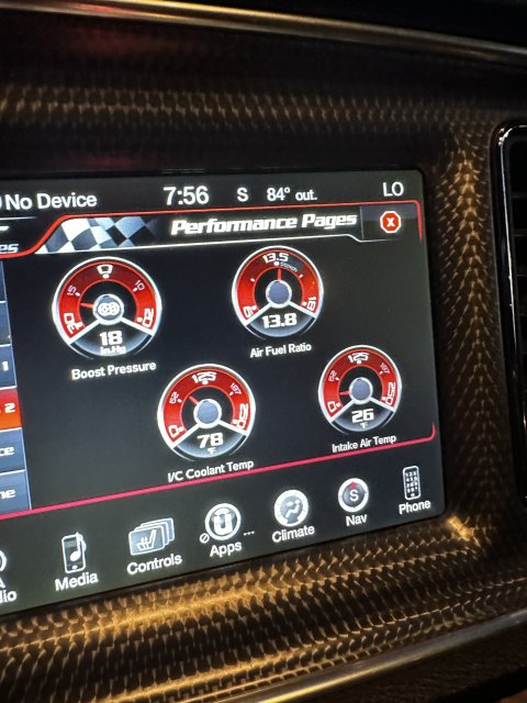

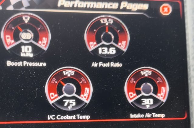

🥶🥶🥶 3 mins after startup driving around (drag valve on), IAT plunges when going wot. (Yes my gauges are flipped)

Thread Starter #146
Also, stock 1234yf, as it should be. Zero leaks. Expecting the compressor to live a long time

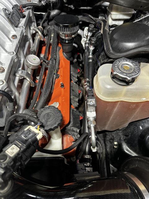

Thread Starter #147
All I can say is wow, idle for 5 mins. Supercharger is cold. As everyone knows, with older hellcats the gauges are flipped. I/c coolant temp is actually IAT, and IAT is actually I/c coolant temp. So 26* coolant temp. Once you get on the car a bit or wot IATs plunge. They’re still below ambient at idle (which is awesome!) but they plunge more when you have more air flowing over the supercharger bricks

Nice temps, I may have to update my kit to the block exp valve. How much freon did they put back in yours?
28.5-29 because the car calls for 25 stock. 1234yf. I guess I crimped and lubed all my rings good, zero leaks or issues held vacuum from a machine for an hour

Thread Starter #150
AC guy said expansion valve was working great. I can’t believe how quickly it gets cold, then again with all my hoses (stock tank) only took about 1.5 gallons of fluid when filling

Thread Starter #152
My suction line is right up against my radiator overflow hope it’s ok like that. I bet it would get cooler if it wasn’t and I had it insulated

Thread Starter #154
Very impressed. I’m a believer now. I was expecting it to get down to 40 min
