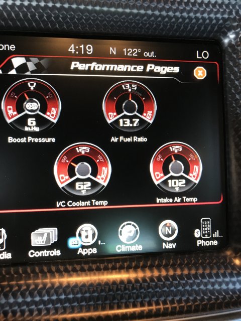

Sorry....I just can’t help myself. I have one of the FI Interchillers installed. I also have a big Whipple supercharger that makes a lot more heat than the stock SC. If anybody is wondering exactly what one of those things do..... here’s my IC and IAT after idling for 30 minutes in the afternoon Phoenix heat in back of the shop (check that outside air temp!). 1A1D86B1-B372-47CB-9EF0-5DE71CB798A9.jpeg

Sorry....I just can’t help myself. I have one of the FI Interchillers installed. I also have a big Whipple supercharger that makes a lot more heat than the stock SC. If anybody is wondering exactly what one of those things do..... here’s my IC and IAT after idling for 30 minutes in the afternoon Phoenix heat in back of the shop (check that outside air temp!). View attachment 3132
