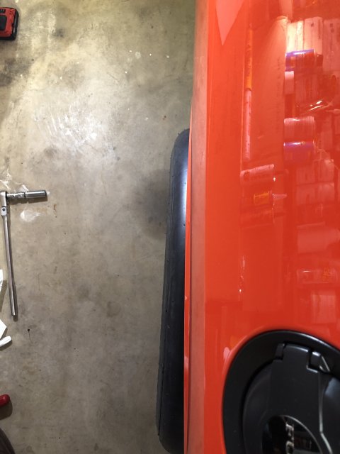

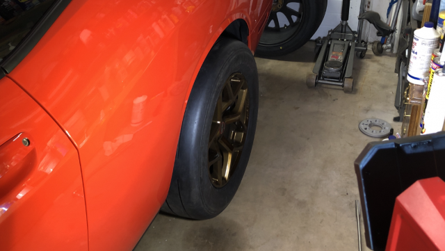

Do you have any side pictures to see how much it's poking out? I can't justify a hammer to my car as of yet either, but I'd like to run 315s too!

Started with 11 mm, they rubbed when cornering and upon being aired down to 18 psi in straight line so made another set at 14 mm. I drew the sketch, machine shop buddy made them for me. He’s making another set now for a member, $160 shipped. Could probably get him to make more but need to know quick.

Would Not exactly be pretty on the street but I don’t plan on ever running them on the street. Veteran track guy told me to just run them on the track, get them seasoned with track prep and not run them any where else, not even back and forth to the track for best performance and longest life. Going to try that this season
