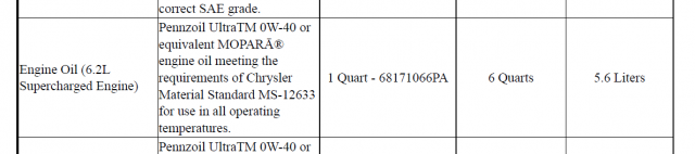

The factory service manual I purchased in 2020 for my 2016 says 6 as well. Wonder why they wouldn’t have updated that, it’s all electronic.

#56
FSM states 6 quarts for 2015-16 cars.
