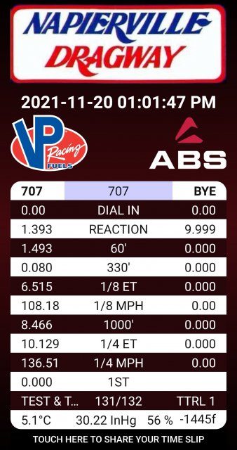

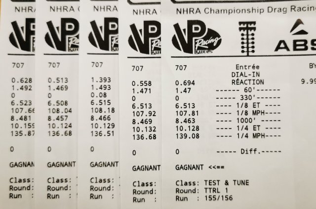

Here are the slips from today in order of runs from left to right.
59,695
207,820
My mph was off from a week ago except for the last run.
It was a different tune and I was going to switch back but didn't get a chance.
I think it might have been faster.
But it is hard to say as I was losing traction at the big end and having to chase the car.
Then the last run was like that the whole run and my mph was where I would have thought it would be.🤷
where all runs in the same lane? I have brought this up before but not uncommon for the mph to by off lane to lane at the 1/8th or 1/4 mile. Mine track this is common every time I go. Could be any combo of 1/8 mile or 1/4 or either lane. I always try to run both to see what is going on

The 139 makes no sense based off the others. Our track also has 1000 ft mph so we can compare that also
All runs in the left lane.
I have to look at the logs.
I added Octane Booster before leaving home.
Did it take that long to get mixed and work? I don't know until I look at the logs.
The different tune could be why it wasn't a bigger difference.
Trying things doesn't always work out as planned.
His car us a unicorn farting rainbows.... Maybe he gave it an extra helping of chilly before that run .

I'm looking at every incremental of the run and based on the other time slips it could not have run 139 without picking up through out the run on that pass
4,875
11,025
I believe it's a glitch too based on all the other slips and the stats on that run . It might have been something blowing across the track and through the beam . But that a side the rest is consistent and is proof of an improvement I will be reviewing the logs .
On to that run I used up allot of track and crossed the line to the left of the lane vs all the others I was pulling the car away from the right of the lane.
Remember crown of the track .. maybe?
Or I just travelled so much further from right to left I picked up more speed. 🤣🤣
Sorry going to my corner again.
Its a good theory. once I look at the log I will know for sure . your speed is recorded on it. I`m not counting anything out yet !
So I looks like sliding sideways through the traps will trigger it earlier lol . On the 5th run you let out earlier then the other runs I'm assuming due to . All 5 logs are smooth and clean .
That a side, show me another stock pulley'd, stock ignition table hellcat on pump gas that will run 10.12 @ 136 mph consistently on the same day !

for how much better the DA was and you didn't pick up much, I wonder if it needed more fuel?
Yes he needs more fuel . He is changing things bit by bit as not to go to much to fast . Every revision the car is getting faster so he is going in the right direction .
While having all seats, trunk mat , floor mats, compressor... You know. 😉
