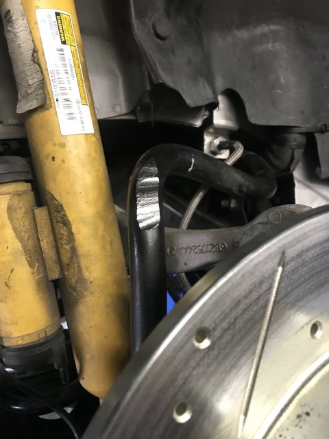

Also had to grind in the sway bar on passenger side , it does make you question structural integrity 🤔
4,875
11,025
Sorry but way too much grinding for me .
3,630
11,710
Hmmm. Probably unnecessary question but.... is the bar centered? I replaced my sway bar with a 1320 bar and did not have to grind any on the bar. The stock bar has ridges that place it in one position. The 1320 bar does not have those so it can be moved side to side to place it where you need to get it away from the wheel if it’s too close on one side.
It could be off some but checking clearance on other side there was much injury either
Wish youda called me before you did this. Coulda helped you eliminate 90% of the grinding
