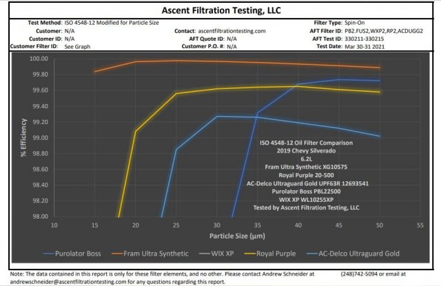

What's interesting about the "XP" versions of the WIX filters is they "open" them up, presumably to allow for greater flow as they get older???
When I saw that, I stopped using the "XP" versions of WIX filters and went back to the normal versions.

LOL, I don't, but I had allowed myself to believe that the XP version was a better filter, if you take the specs at face value, it's not "better", it's "freer flowing"...

Without an efficiency rating, the micron spec is pretty meaningless. 99.9% @ 20 is the best I've seen. This would be something like 50% @ 5-10 microns. (Don't know where the Wix went on the graph.)
The scaling on this graph is a bit misleading...
The vertical axis being only 2%...

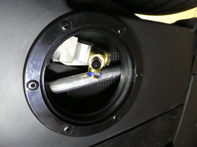

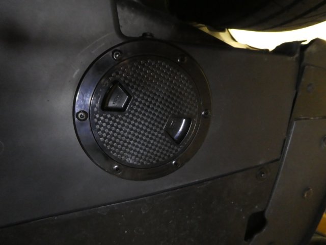

If you got the access panel that a member was selling a while back it’s a piece of cake. If you are original, it’s still not hard. You’ll just have like 19 fasteners instead of 8.

did this on mine for oil cooler drain access - saves a lot fastener R&R as noted above.

I always drain with the oil fairly hot. I usually get several ounces (6-8?). Four 10mm bolts with a nut driver isn’t much trouble, imo.
But I agree, probably not necessary in the long run.
Same here (fairly hot). Will look at it and make my determination. My OCIs are every 3,000 - 4,000 miles so (6-8) ounces on a 7 quart sump probably doesn't make a difference? Probably do it so I can learn and use an RV mod piece to gain easy access going forward. I should have ordered one of those access doors when I had the chance.

Not filter related, but I installed Stahlbus valves, on my Cat. Not enough room, for Fumoto valves. Keeps things tidy, during drain ops.

Hmmm, well I have two Fumotos on my '16 and they fit just fine - one is shown in Post #30. Need to know the right models to use ;-)
Yeah! That looks good.
I considered that model, but went with Stahbus, instead. Ran Fumoto on my 6.1 and the wife's 5.7 Magnum, for years. Figured I'd change things up.
