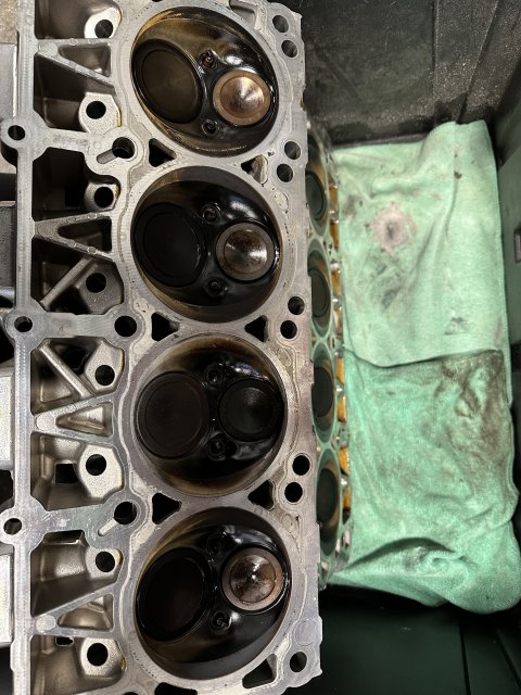

Any opinions on if there is an engineering or manufacturing defect in the block with cylinder #2?
Bowlerguy92
Bowlerguy92
#16701
351
1,009
Thread Starter #152
I'm not smart enough to know. Pending the fuel injector not having actually failed, it sounds like some kind of tolerance issue with the piston rings based on what @Hatermkr has hypothesized. I'd love to know, though and get some closure on this if it isn't the fuel injector.
I hope someone figures it out at some point......It no coincidence that cylinder #2 is always the issue 99% of the time.
8,520
7,452
Better question is how did the spark plug look on cylinder 2? That’s the dead give away and I’m surprised no one checks plugs anymore with modern engines

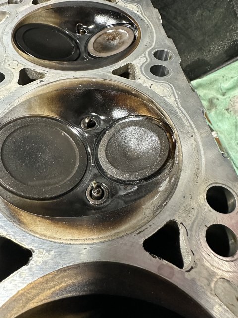

From the photos sent here, he had number 4 fail not number 2? To me it looks like heat in that cylinder caused this meltdown. Definitely not a defect.
Bowlerguy92
Bowlerguy92
#16701
351
1,009
Thread Starter #158
I'm not sure. Shop said cylinder 2 but didn't have it front of him at that minute. Maybe someone else can confirm. If it's not cylinder 2 then very possible the injector actually did fail and we'll find that out shortly. *edit* I guess based on a diagram, it is indeed cylinder 4.
8,520
7,452
I
If injector failed plug would show it.

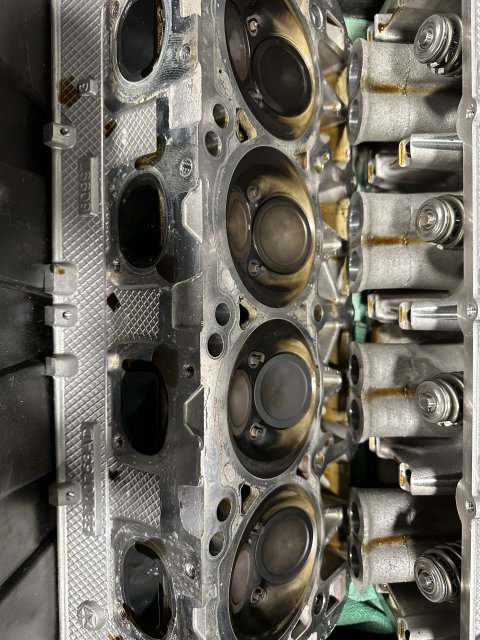

Here are the pictures of the heads. Tough to tell from an image the plug condition. Hater can take a look for himself as well.
