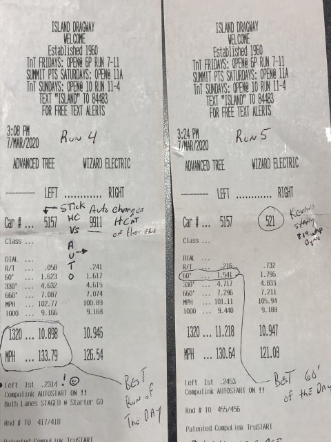

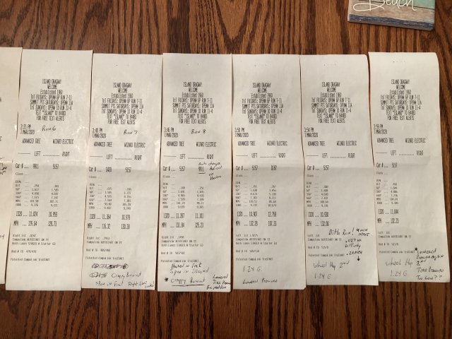

F26C5FF0-EC37-47C6-AC1B-9D462E0E56AD.jpeg 62CD4509-1667-4036-8BF1-090FD5664415.jpeg So my 60’s at 1.55-1.60 pretty good on the 17” 315 MT Street R’s ?
I was trying to get lower by lowering tire pressure but started getting wheel hop hitting second (M6) Will too low of tire pressure start inducing wheel hop? As that wasn’t happening during prior runs that same day
My BMR lower trailing arms just arrived today so they should help as well. See in pictures, best 60’ was earlier in the day, I kept lowering tire pressure as my digital gauge said it was up to 20 after a run so kept taking it back down to 18 but maybe my gauge was misleading me??

Wheel hop happens at the "stick slip" point of traction.
3,689
8,704
Agree, but is there a point that too low of tire pressure can lead to it happening easier? Or could deteriorating track conditions be more of the cause? I was hooking up good at one point then wheel hop started. Track closed before I could try a higher pressure and see if it changed things or not. Only asking because I’m kind of green in running tires with this big of sidewall (315/50-17) at this low of pressures, 16-20 psi, and what can lead to what. Just measured the tires static, not on the car, sitting in the 68 F garage, 16 psi, that too low??

radials should be run at 18-20 psi too low and they will fold and can cause wheel hop as well
