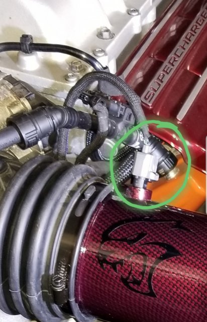

The 2018 and up have a IAT sensor instead of a MAF sensor. I log MAT, IAT , ambient temperature, and air charge temperature in my logs for a comparison .
Hpindy is that IAT sensor in the intake tube on 18 and up shown anywhere on the performance pages?
I think what I'm currently seeing on inlet air temp on the performance pages is post or after blower discharge temps.

Speedy I think on 18's+ it's a post blower temp we are seeing on the performance pages as IAT temp. I'm not sure where that inlet tube sensor that is pre throttlebody is being read at.

I'm not sure . On my performance pages I have a guage called " intake air temperature " and to be honest I'm not sure where it gets its data from . But I can tell you this if the ambient temp is 60F and my low speed IAT reading is 90F and I flash the throttle it will drop to about 80F instantly and either drop more if the throttle is open still or go back up if the throttle is closed . I have not done any long WOT pulls yet so I don't have any data on WOT yet .
Exactly. I too want to know where this sensor is being read on the air inlet tube.. 20200512_161223.jpg

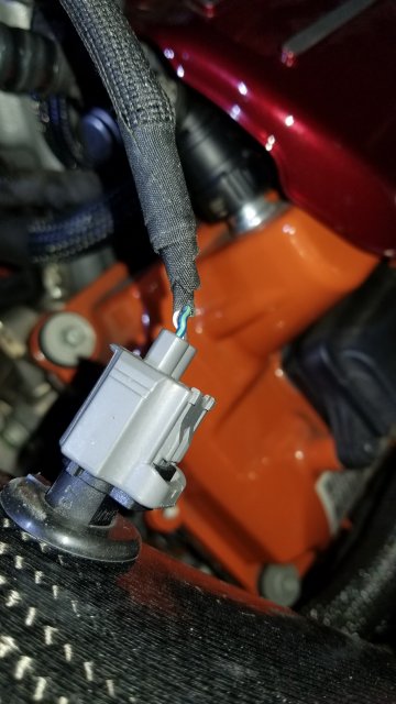

Exactly. I too want to know where this sensor is being read on the air inlet tube.. View attachment 17352
I wonder if it's used in the calculations. Like it takes reads from ambient, pre throttle body IAT , MAT and uses them to calculate something?

On my 2016 the dash digital gauge labeled "intake air temp" is the one by the throttle body I "think". Do the 2018 and up not have a MAF in the intake tube any longer?
4,875
11,025
#55
No . The MAF is gone on 2018 and up . Just the PVC and IAT sensor now .

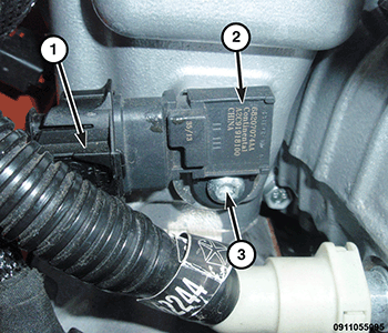

Thanks to @Hpindy for the info on some other temp PIDs to monitor. I added manifold air temp and intake air temp. Intake air temp must be read in the intake tube as it was 4-5° F over ambient. Manifold air temp had the highest readings and aircharge temp (in HPTuners) lined up with what the dash gauge reads as "intake air temp".
