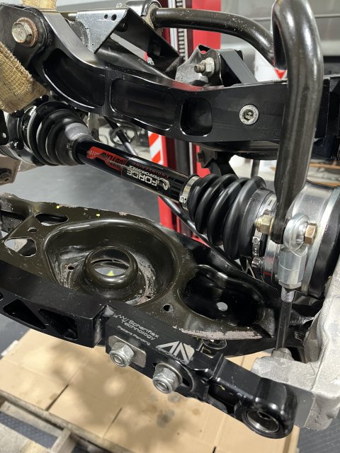

Did you look closely at the picture?
There is actually more to this kit than I initially thought.

$3500 is certainly a good price for what’s in the picture. I see the AAD control arms and Gforce axles along with the differential. I assume the drive shaft is also a part of the package. The fact that it is already assembled means a simple cradle swap and you’re done. That would be some savings as far as labor goes. Downside could be that you are lowering your gear ratio to what will make 1st gear too short to work. Especially as you increase power. Look into what you need to know about launching in 2nd gear. And I will repeat this…. A 15” wheel/tire combination is 1000% better than a 17. I don’t care what kind of performance somebody got on a tight radial prep track with a 17. Real world… on the street and ordinary track surfaces, the 15 works when a 17 doesn’t.

This was the list I saw.
2015+Mopar Modified Cradle &complete 9” IRS kit with 3.25 gears, a 4” aluminum drive shaft and the GForce Outlaw axels currently set up with a spool but also has an Eaton Detroit Truetrac that he would sell me for 25 cents on the dollar.

I do see from your response though that you didn’t catch what I was referencing in the picture, it has what I would assume as the full AAD drag Pack already installed, or at the very least the wheel hop eliminator kit.
The Drag Pack alone would cost me $2500 Canadian.

AAD parts are valuable and as Mark said The Drag pak is $1,499.00 ohn HHP's site and no holiday sale on that yet.
AAD Billet Drag Pack for 05-23 Challenger, Charger, Magnum & 300
Wheel hop eliminator is 1,129.00
AAD Billet Wheel Hop Eliminator Kit for 05-23 Challenger, Charger, Magnum & 300
You are correct and I now think you are getting great parts for the price.
Mark thanks for your input and I see you noticed the AAD stuff in the photo, I didn’t even realize this was included. The one piece aluminum drive shaft is leaning against the wall in the photo.

I will say the phot that you posted is worth well over the price you are offered it for. I will offer my 2 cents. My car runs well into the 7's on a set of DSS level 5 axles, a billet IMS rear, cradle lock out and AAD kit. It really depends on how much power you plan to throw at it? if you are planning a built engine and trans them by all means that is great setup for you. if you aren't going to go all in, a simple cradle lock out, AAD kit and P4D diff brace and you're all set.

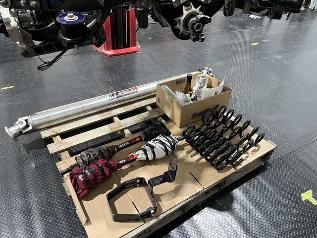

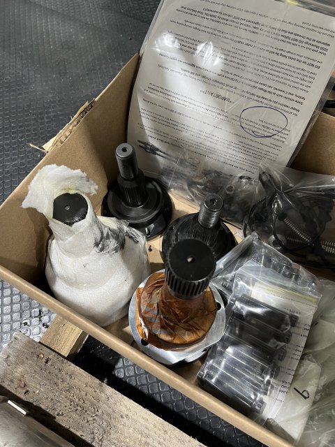

So I picked up all my stuff yesterday and had a tour of the shop, which was amazing. I saw his 1700+ HP Redeye with a huge blower that is running in the 8’s and his 1000HP Street Hellcat that is running in the 9’s.
I won’t post any pictures of the shop or mention his name on social media because I never asked his permission for that, but I can tell you this man is a stellar human being who was willing to share anything he could to help. His shop was amazing with 4 guys working on various builds from resto-mods to custom Harley’s. He had a number of seacans stacked up and layed out inside the shop to section it off and he pointed to one stack and rolled a set of stairs over and said “ this one is full of Redeye parts” and invited me to check them all out. He said” when you want to go faster everything you need is here in this container “.
All of his pro-mod cars and serious race stuff was down in the USA at the moment but he said sometime in May they will be doing testing here and renting the drag strip that is 30 minutes from my house for 3 or 4 days and he invited my wife and I to join them. He said he wants to show me how to do a proper launch and give me a few pointers that will save me some frustration and possibly broken parts and $$. He also mentioned when I am ready to do a tune to give Curt Dusterhoff a call and he would be able to help me with the HP gains.
One huge bonus is everything is already together including all the parts I would have had to switch from my car to the new cradle. I did notice a couple small “issues” with the parts after I got them home but I don’t think they are too serious. The driveshaft boot had a very small puncture or tear in it maybe 1/8-1/4” and there was a small groove maybe .020 thousands of an inch deep in the driveshaft where it had rubbed against something. The other thing I noticed is the rear stabilizer bar had made contact with a piece of the AAD kit, likely more than once, and left a blemish where it rubbed some of the aluminum away, you can see this in the last picture.
I also got a spare set of brand new outlaw axels and another set of inner and outer stubs and a set of springs. They couldn’t remember exactly what springs they were other than those were the ones they were told to use.
Overall it was a very exciting day and I feel extremely fortunate that I have made a great contact who seems more than willing to help me and share any information he could.

Yesterday for the first time, I actually got to see a picture of everything included in this deal.
I respectfully invite everyone who has taken the time to read this thread and share their opinions to look at the attached photo and tell me wether you still feel the same way, considering I would be paying about $3500 American for everything you see.

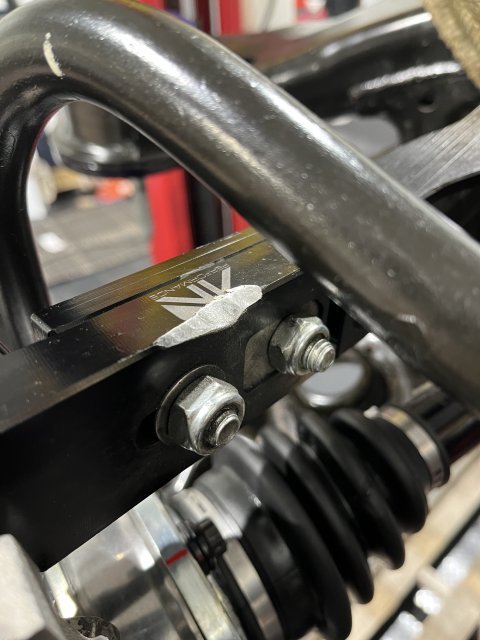

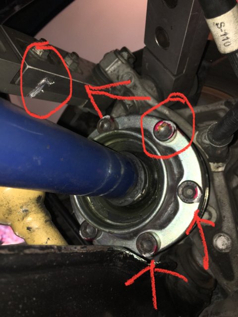

So I have a lot of things to address and account for it seems and I will try to do so.
1) I already knew I was going to ruffle some feathers by not following the advise I asked for and received and I even stated it previously. I did take everyone’s advice into consideration and hope you don’t feel like you wasted your time even though I didn’t follow it exactly.
2) I knew and realized this complete set up was overkill for my current HP but I am not sure how that makes it bad unless I was actually paying full retail and I completely agree that would be a waste of $$
3) This set up comes with the complete AAD Drag Pack which I can easily take off and put on my car and not even install the rest of the modified cradle if I choose. The AAD kit would cost me $2500+ CDN new
4) The driveshaft would cost me about $2000 CDN new

1) the driveshaft groove !
I admit that somehow I did not notice it at the time, I was on a bit of sensory overload from the shop tour and by the time we got to my parts the driveshaft got loaded into my truck as I was talking. I don’t believe it was done to hide anything and am sure I could get back my money for that if I asked. Which I may.
I will say here that although I am not a racer or mechanic I was a licensed machinist and tool and die maker for almost 20 years so I have a very good understanding of different metals and a degree of mechanical aptitude.
Part of the reason I missed the groove is because it was fairly “minor” I have physically measured the groove compared to the shaft and it is about .020” deep. To be exact the driveshaft OD was 3.980” diameter and the groove measured a diameter of 3.940”.
Aluminum is very soft so it wouldn’t have taken much to do this damage however it does concern me because I have zero driveshaft experience and am not sure if this would be enough damage to create a failure point or possibly an out of balance issue.
I would need to find these things out to be comfortable.
2) The damage to the AAD arm was also very minimal and this I am confident will pose zero issue to its function. The AAD stuff is very impressive and well built and it’s easy for me to see nothing is bent or out of whack. Again aluminum as you all know is very soft and the stabilizer bar on the other hand is quite hard so it wouldn’t have taken much contact or rubbing to produce the damage there was. I already cleaned it up with a small file and some emery paper.

IDK, looks like this can still happen depending on the spring set etc. used…

My advice when there is a clearance issue and something is making contact… massage it enough to stop the problem. Modifications sometimes require that. It’s part of the game.
9,589
56,526
#60
At what point do we diminish the structural value of the item? Lots of power to resist back there, from the vehicle and the way some of us drive from the suspension.
