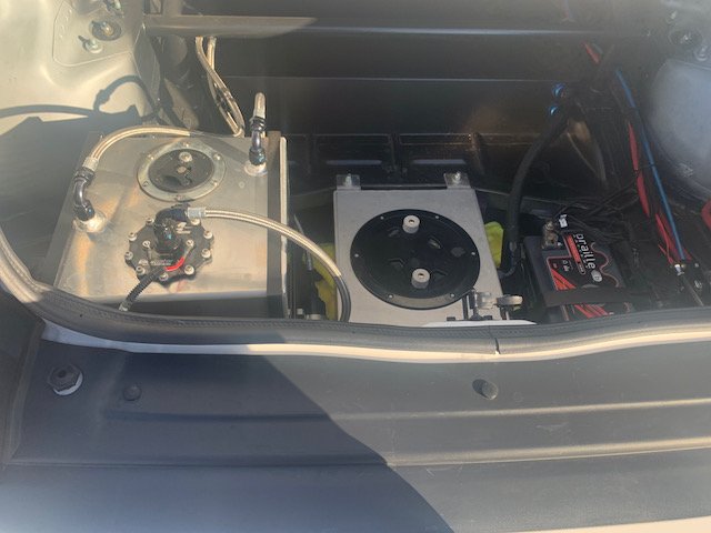

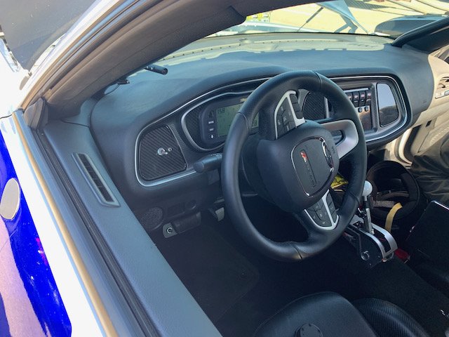

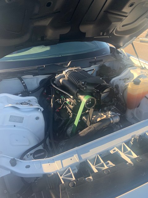

I had the pleasure of pitting next to a Drag Pack at the legion of Demons in Houston. It's a really nice ride, and was brand new to the owner, so he was just getting used to it. Pretty strong but has at least a little ways to go to be 1800 HP and 7's kind of strong
Skip the first half of the video, (I'll work on my editing skills) was 8.80 can't remember the mph
https://youtu.be/qL1181o2m2k

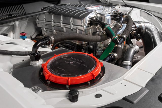

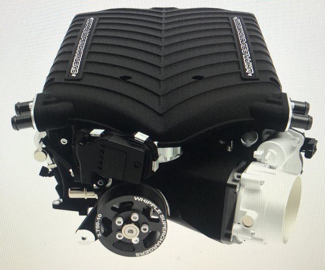

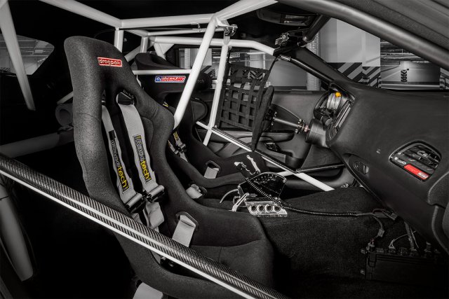

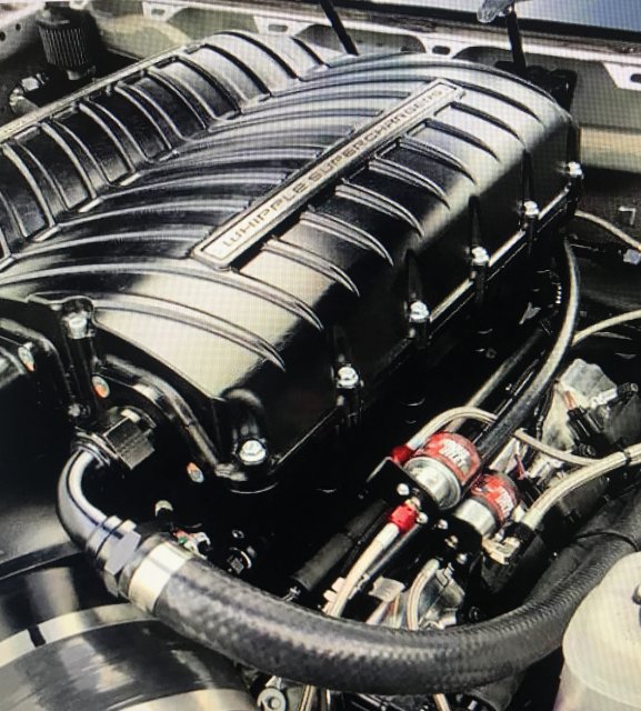

AAF45C62-B71D-4205-A879-9CC5C999A350.jpeg 5932B5B4-74AE-439F-B6D0-86412923D89C.jpeg That’s the old one. New one is a completely different animal.

A couple things to know about the new 3.0 Whipple ready to hit the market. 1..... don’t confuse it with the 3.0 DragPak version. There are obviously some differences. The plenum volume on the old 4.5 was extremely compromised (as is performance) in order to fit under the stock hood. That was a marketing decision that was made because it’s hard to sell something that requires you cut or replace the stock hood on the car. Looking at the DragPak version it looks big. Comparing the pictures of those with the ones just released of the new street version, it looks like the volume under the lid may have been reduced some as well. The shape is different and the IC plumbing is different. So basically..... I wouldn’t expect the street 3.0 being released now to have the capabilities of that DragPak (it will fit under the hood however). Inquires by myself and others about using the DragPak 3.0 on our Hellcats ended up with us being told that it can not be done using the OE electronics. The throttle body is manual and a stand alone tuner (Holly EFI) needs to replace the PCM. Personally, I think this new Whipple will doom the modded IHI as the choice for increased performance over stock. Time to sell those while they’re still worth something 😂 27C8E8A4-FFFB-432E-872A-5F9F3C4DEB7F.jpeg 80EFBD6A-E219-449C-9C01-6EB4EA1F1231.jpeg

This is what Lethal Performance states
  • Over 300HP capacity over Hellaphant 3.0L Supercharger
  • Over 500hp capacity over Hellcat 2.4L supercharger
  • Expensive porting not required to make power
  • Massive, dual pass, dual core intercooler technology for twice the cooling area of any other PD SC for 6.2L
  • Inverted design allows for oversized intercooler, each core is 2.125” thick, dual pass = 4.25” thick core
  • Dual in, dual out intercooler for increased water flow
  • 112mm opening for compatibility with stock TB, 102mm, 105mm and Whipple’s 112mm
  • Billet rotors far superior to cast rotors for high rpm operation
  • ¾ rotor vs 3/5, 33% lower male rotor speed
  • Superior profile with shorter leak path
  • Thrust retaining system for better bearing support
  • Massive air inlet for high flow (porting not required to get power)
  • Optional high flow cold air system
  • Fits stock fuel rail, stock injectors or billet Whipple -8 rails
  • Works with stock belt system and optional balancer options
  • Works with electronic bypass control
  • Works with stock TMAP sensors
  • New over bearing 5-bolt supercharger pulleys
  • Billet bearing plate and oil cover
  • Custom colors available
My stock 2.4 blower makes about 880/900 to the wheels on boost, based on the above, this equates to almost 1,400 at the wheel at 7,000 rpm. Now if I could spin the motor to 9,500 rpm or higher like the drag pak can do, what is the HP? It appears to be very similar to the drag pak performance,
