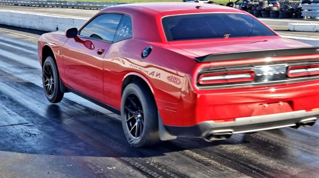

I think I saw daylight under that front tire!
