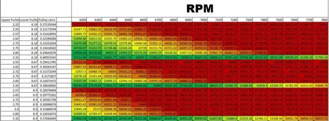

Here's the blower efficiency data I have. I think HPindy may have first posted this?
