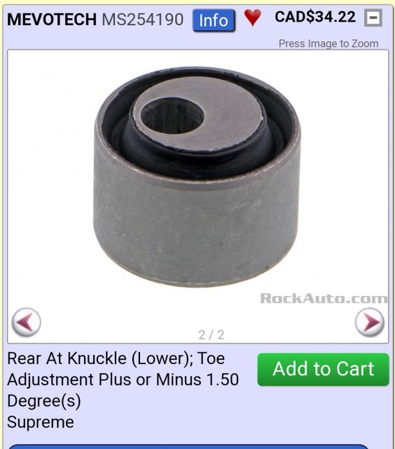

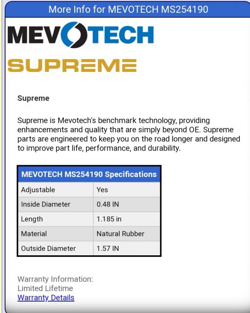

I looked on Rockauto and they don't have it listed but they have the Mevotech equivalent. The pn for the Moog is K100173
This should give you an idea. Screenshot_20230326_123903.jpg Screenshot_20230326_123828_com.android.chrome_edit_2005878305938194.jpg Screenshot_20230326_123833_com.android.chrome_edit_2005907625878294.jpg

So does this adjust camber or toe
Camber. It installs on the knuckle end of the rear upper arm. The Moog one has notches in it so you know what position you are installing it in.
