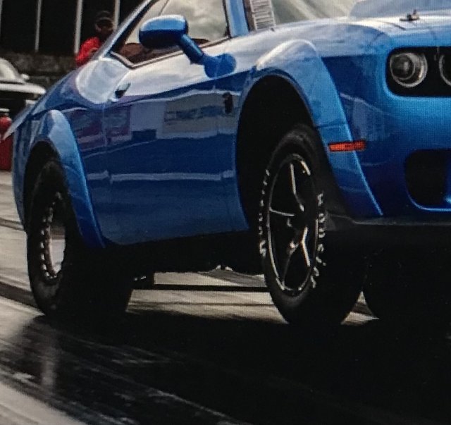

#60
Sportsman is the best choice if the car is street driven. Period. The ET-R is a good choice if mostly a track car with cautious street use. The light weight M/T that I’m using is a 17”. That tire is not available in a 18” and is race only. If you want a lighter 18” tire for racing then the Hoosiers are the best choice. Many fast Hellcats using those without issues. 079D9076-BE8E-4520-B9F0-26B6AC767320.jpeg
