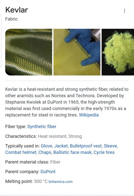

Also, Kevlar material is used on some engine diapers which is fire and heat resistant.
