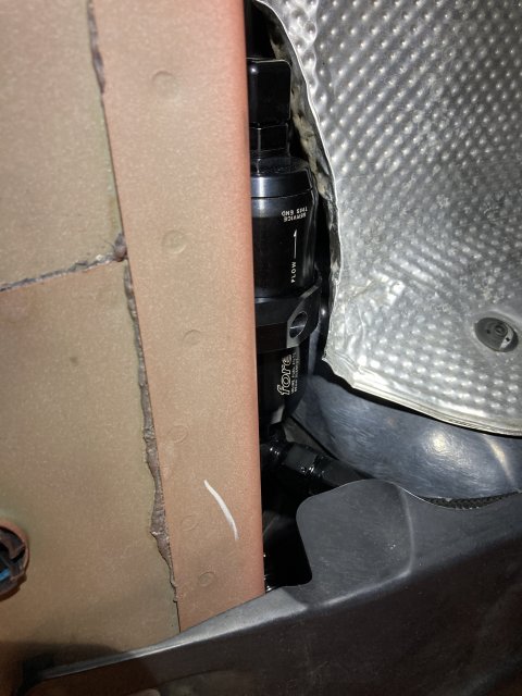

Where is it supposed to be installed? Like under the car? In the engine compartment etc.
3,657
8,594
I’ll post some pictures in a bit be patient, I looked for them this morning for 20 minutes I have 25,000 pictures on my phone wait till I get to work and I could screw off on their time lol
2,309
5,509
I went with twin 285's from tapped and one of the pump's had a small crack in the nipple so couldn't build pressure. I have to say Rick's customer service was top notch. He returned my call over the weekend, helped me diagnose the problem, and shipped me a replacement pump next day air. (y)
Under the car somewhere near the fuel tanks.

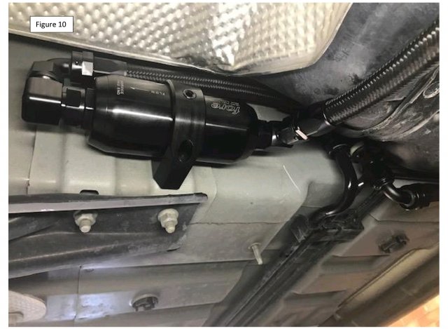

I'm pretty sure that the HHP pump is a plug and play except for the filter, which looks like the same thing in the instructions.

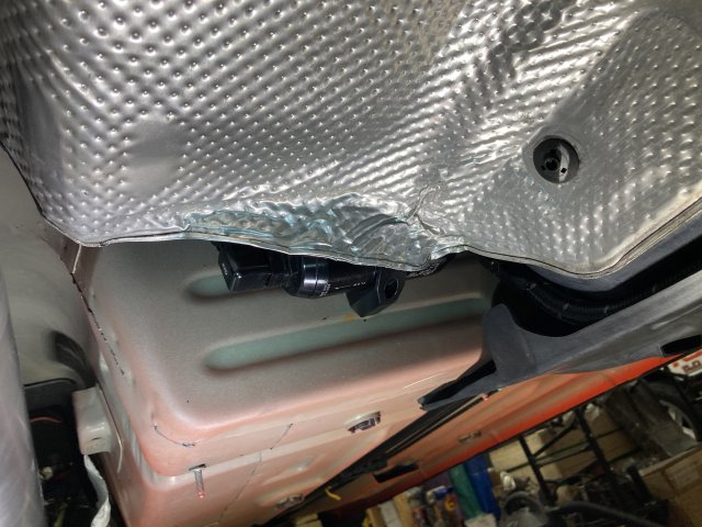

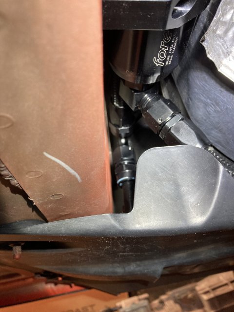

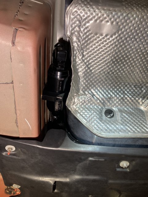

Not invasive at all, sorry to take so long, busy day at work today with real work I’m paid to do lol
Hope you guys can make heads and tails out of these pics.
4C9DDA56-74D9-4B72-B2EB-FF2E725E48A8.jpeg 5E67090D-4DAA-42A4-B638-2C0D4C35C2C1.jpeg E11F25F4-C723-46EF-B7E2-2A28F5E0D43E.jpeg BE614D39-06AC-4546-8AF4-5247BFE65F65.jpeg
7,194
18,689
All the bends gave me some concern....probably fine based on the fuel pressure but still bothered me.
16,524
51,746
Is all of the plumbing "plug and play"?
Obviously it's different, but you don't have to cut, crimp, hack, mutilate, fold or spindle anything???
