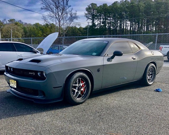

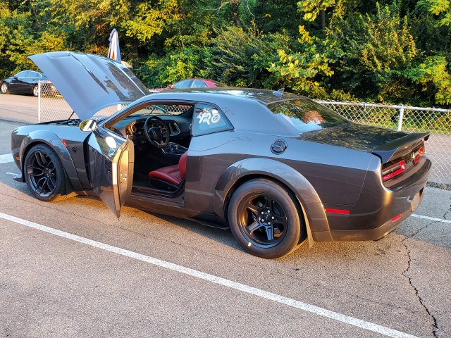

In IMG_2929.JPG between showers
555 Redeye

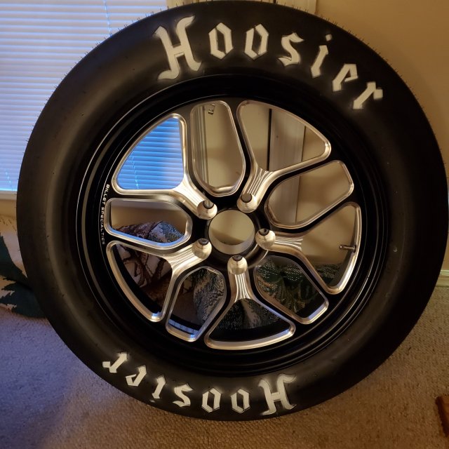

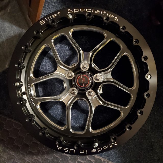

Currently; Billet Specialties 18 X 5 front wheels with Hoosier 28 X 4.5 - 18s and OE Demon wheels with MT 305 18s ET Street Rs on the rear. Will be going to the Billet Specialties 17 X 10 wheel that matches the front skinny with MT 315/50/17s for the rears. The fronts with the Hoosiers only weigh 26.4 lbs. Added 4/1/20: Got the matching billet rears mounted with the MT 315/50/17s. Now hoping there will be a 2020 season at my track.
20190711_203314.jpg 20200110_172713.jpg 20200319_214020.jpg 20200331_143138.jpg

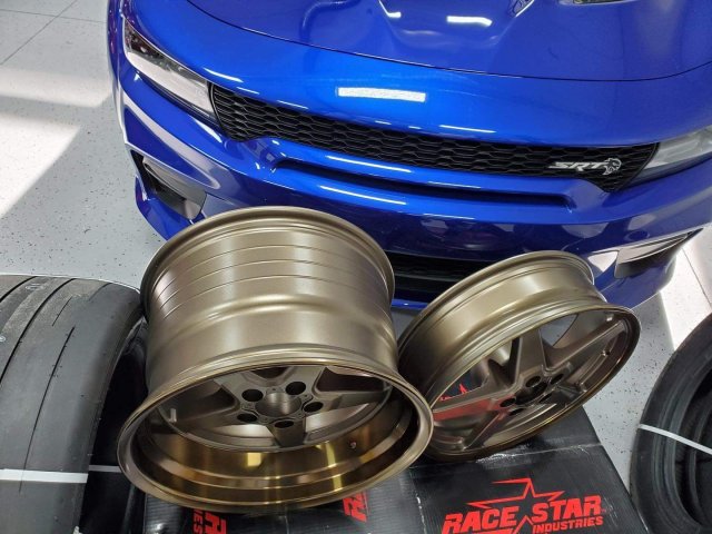

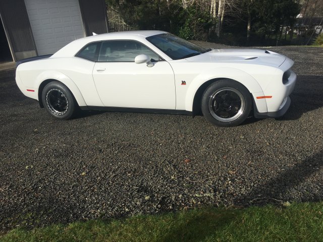

My new setup for the spring! Racestar 17x9.5 and some P305/45R17 Mickey Thomson ET Street R's.

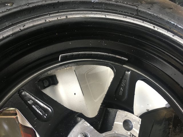

For the guys running the race stars; you guys get any slippage between the rim & tire?
Seems very common. I am going to clean the paint off the barrel mounting surfaces a with an aggressive roloc disc and knurl that area with a chisel (?) before mounting my drag radials.

#71
I don't have them mounted yet so slippage to report here!

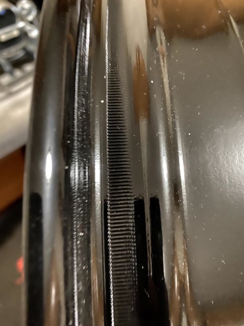

BUT, I did take a look at the wheel and it appears the factory put a knurl on the wheel. Not sure if that is new or if it helps.

#72
Wow! Ty for the heads up! I wonder when they made that running change. The last pair I bought was over a year ago for the Slomaro. Never really worried about tire slippage then since it doesn't make the type of power our H/Cs make.

#73
Wild development. I just check the wheels I got late last year (and these were the newer widebody spec 17x11s) and they definitely didn't have it at the time; and there is no announcement on their website or FB about the change.
They do offer a "direct drill" option now, which may negate the need for a hub-centric ring kit.

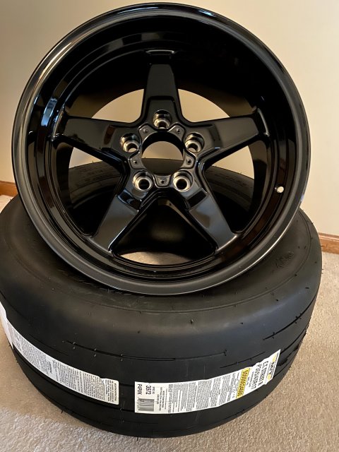

Brand new 17x11s that don't have knurling, going on JLT's WB:

#78
That little bit of knurling is not enough to keep the tire from spinning on the rim. I had to take a dremel to mine and put a cross hatch pattern on the vertical surfaces, both sides. I also sprayed the rim with gasket tack spray before mounting the beads. It's held ever since, about four months now.

#80
Update, tire spun on the rim at the drag strip today. Back to square one.
