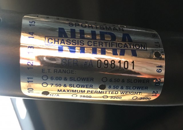

Heavy weight was getting too fast. There’s no way to cert a cage for the numbers those things with over 2000 hp are running. FSS is too expensive to be competitive in at the high level. Million dollar budget to go there. Thank the NHRA for that. A factory DragPak will run 8.00 if it’s left as it came. Those engines would be just as reliable if they limited the boost, timing and rpm as is proposed here. I think a “limited” DragPak class is a good idea. Don’t care for the requirement to buy a package engine though. Pretty easy to do a data log after a win in eliminations to confirm requirements.

Marc,
What are you talking about, "getting too fast"? Is there a weight limit on an 8.50 or 7.50 cage?

Yes there are weight limits on the cage certs. See the bottom of my 7.50 cert sticker. Max weight is 3600 lbs. IMG_2287.jpeg

Yes, but was your car weighed? Mine was not BOTH times it was certified

No. The car wasn’t even completely together at the time the cage was inspected and certified. The cert just says the ‘cage’ meets the requirements. Not the rest of the car (including weight). That’s up to tech at the track. It’s not my idea. The weight limit is right there on the sticker. I’m just pointing out that, according to the NHRA, if my car weighs over 3600 lbs, it’s not legal with its current certification. The NHRA can change this if they want but they are continuously behind where they should be with stuff like this. Fortunately, tech is either unaware of what these things weigh or look the other way because they have never required me to weigh in as a part of tech.

We’re talking about MSHS though lol

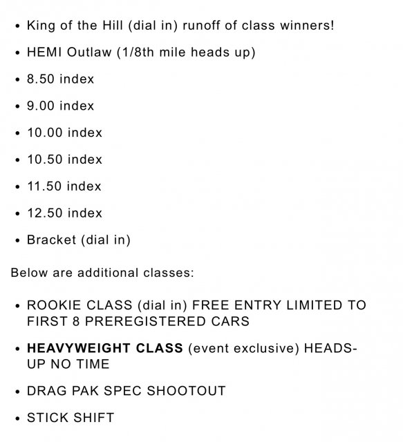

Buy an engine for a class that exists in 1 competition while getting rid of others. Was anyone running 7s in heavyweight? Looks like Heavyweight is still on the menu for Orlando only! An event exclusive next weekend! Good.

There is N/A as an option. So if the cage is certified for 2800 lbs is there more bars or something to make it for 3600 lbs?

The difference is tubing size and placement (how many and where) The requirements are laid out in the NHRA rulebook. The difference between a 8.50 cage and a 7.50 cage is huge. 8.50 is nothing by comparison. I found a picture of my 8.50 cert sticker back when and there is no weight limit at that level for a modern muscle car like ours. The N/A is punched. The certs where you go faster than 8.50 is where the max weight limits come in. The 7.50 cert involves the floor, the overhead and even behind the firewall. I’ve shown this before but… once again 😵‍💫 IMG_2270.jpeg IMG_8107.jpeg
