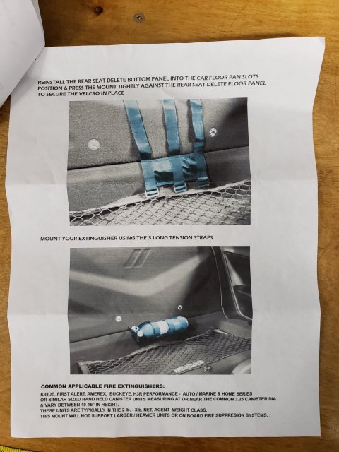

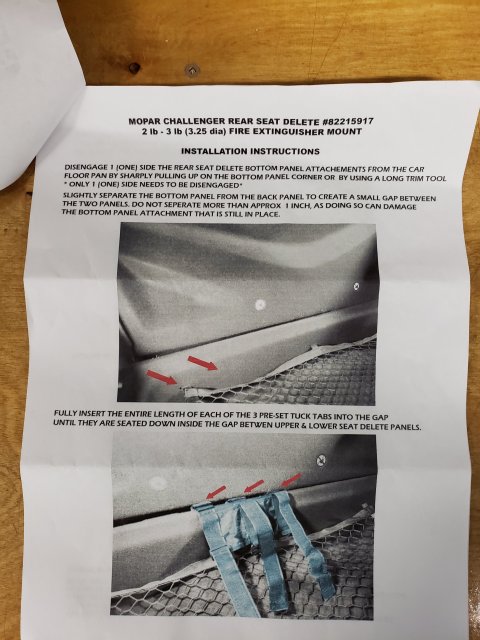

its a Genpartsco mount just for the rear seat delete
I found it on their site but they don't state how it mounts to the car. My rear seat delete was one of the first ones and did not have the little plastic access door to install the harness bar. Is that required to mount the extinguisher?

Instructions that came with are pretty straight forward. my HC seat delete doesnt have the harness bar cutout either, it doesnt mount to that.

Can you post them or email them? I wanna make sure it'll work for my setup.

@Speedy here is instructions for FE mount from Genpartsco. 1568932143602890581446549020897.jpg 1568932143602890581446549020897.jpg 1568932174570452045108097923181.jpg 15689322315103892382791123771875.jpg
