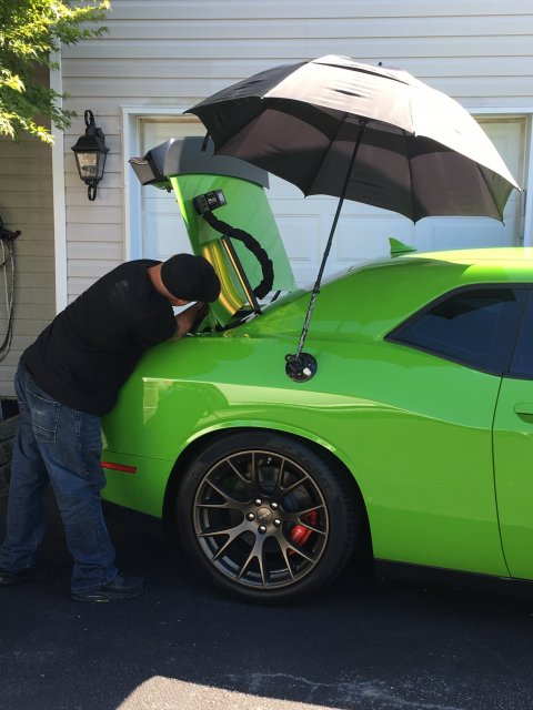

Agreed that the crease is the worst part. I had one on the crease and my guy got it out. I mean it’s not perfect, but I decided to go that route rather than use the body guy that wanted $350. I think they drill tiny pilot hole and pull it from the outside. Mine was a pretty bad door ding from my wonderful daughter. You can’t notice it really unless you know it’s there $80 View attachment 16199 View attachment 16200

Friggin’ a-hole move on my part caused something to fall on the car. 2 dents right behind the passenger side door. One dent below the body line and one right on the damn thing! I’m so pissed at myself!!! Ive got a great body guy but I hate to worry about paint match. Thoughts please.
Like a lot of guys have said...the really good ones are absolutely amazing...go for it...

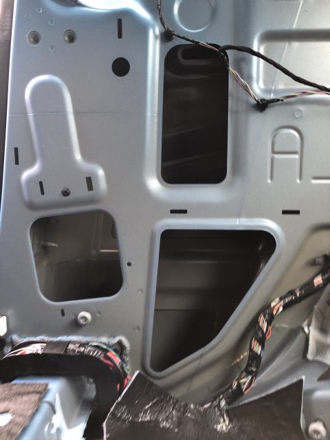

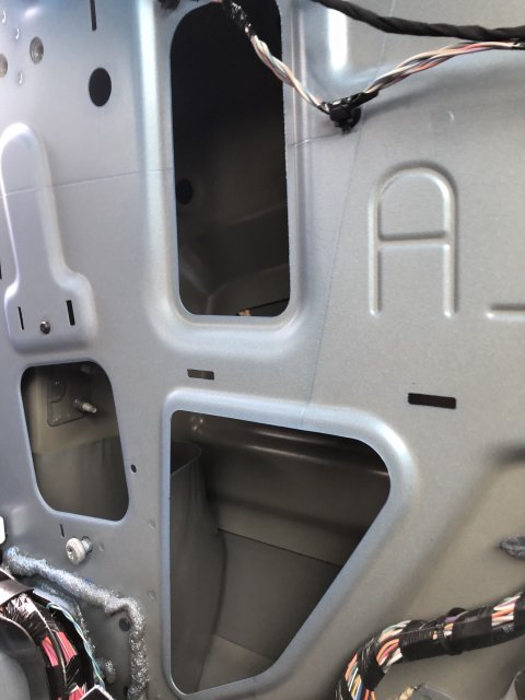

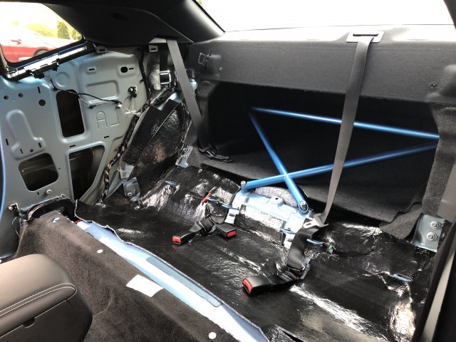

Ill have to pick up the book Stormtrooper. Thanks. So here’s the latest: went to see a guy my cousin (another car guy) recommended. Ive got an appointment for next Monday for repair. In the meantime I pulled the interior out of the rear to make it easier for the guy, and cheaper for me. What I have pictured is what he’s going to have to deal with. Plenty of wiggle room in the cabin but plenty of bracing between him and the exterior panel. Too bad the Mopar rear seat delete kit isn’t available, I’m pretty much there.
D623AEFF-F3D0-45E4-BE9F-DF208DE153E4.jpeg 77211A2B-8EC2-4E77-B0D8-DD83448DA5CA.jpeg 5CB222B3-3500-4067-AC84-2A6313325373.jpeg
lol, you didn't remove that factory trunk brace?!
That should make it a piece of cake.
