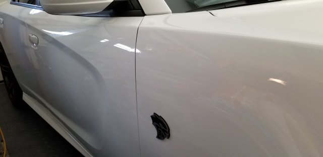

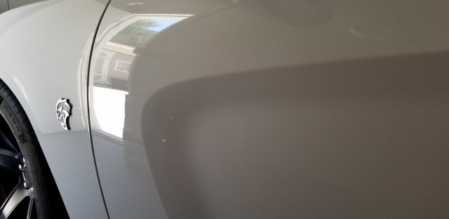

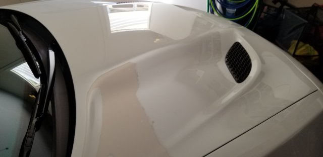

Spent the last couple of days doing some exploratory paint correction on my Charger. White is incredibly difficult to see without a detail light. After 2 years paint isn't too bad...no swirls whatsoever, but little micro scratches (as to be expected). Decided to do some light (instead of more aggressive) polishing as trade off to improvement vs. clear coat loss wasn't worth it to me. Used the rest of my Chemical Guys White Light (glaze with filler polish) then coat of Sonax Polymer Net Shield. Noticed an additional increase in color richness with the glaze (polish and fillers helping hide stuff) under the Sonax PNS. Question is, will the glaze/filler base coat decrease Sonax PNS's longevity? My assumption is it would? Guess I will find out.

Whenever using a polymer or ceramic coating it’s always best to start with fresh unprotected paint. After I polish (sonax perfect finish for me) I will use eraser and then coat with whatever I’m using. I’m personally not a fan of the fillers. But as far as longevity, as long as you’re washing properly and drying properly you probably won’t notice much of a decrease in longevity.

Appreciate it. Thanks.

Picture, picture, picture, picture!

Hard to see paint as it is inside right now...will take out in sunlight.
Only question is how much the glaze underneath will impact sealant life.
